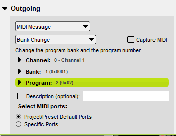

I am trying to use Bome Pro to manage my BeatBuddy. I am trying to send a Bank Select Message (Bank MSB and LSB) and Program change together. Per the midi instructions from BeatBuddy this is what I need to send. I can not fore the live of me figure out how to set this in the Outgoing options with in Bome. I see how to do a bank select and a program change but I don't see how to do them together. I have created a bank select action first and then has program change execute after it but as you can imagine that did not work....please help!

For outgoing message just select MIDI Message then Bank Change. You can then pick the Bank and Program change you want and it will send them together (bank change then program change) which is how MIDI works.

Thank you for the reply! How do I set the MSB and LSB and Program Change on a Bank Change action. All I see is Channel, Bank and Program. The example BeatBuddy has in their midi manual (https://singularsound.com/downloadable/BeatBuddy-MIDISettings-Firmware-v1.77.pdf) is BANK MSB (CC-0) = 0, BANK LSB (CC-32) = 1, Program Change = 2.
I don’t know how to send that as my outgoing message.

Hi Please see the attached picture. Of Bank 1, Program 2 on channel 1.
If you have a bank number that says something like  MSB 2  LSB 1  Program 2.
You would multiply the MSB by 128 and add it to the LSB so MSB 2 LSB 1 would  be (128*2) + 1 or 257.
So in the case of MSB 2 LSB 1 Program 2 it would be Bank 257 Program 2.
