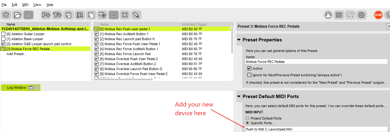

Sorry for my ignorance but looking at your project file I cannot find any device that says Actition. Which presets and translators are your new controller?
2018-04-25 02:27:19
Never mind. I found the right translators.
It appears that you have overridden you input defaults in the preset named “Mobius Force REC Pedals”.
You will need to add you AcctitioN controller to the defined input ports.
See screenshot.

Sorry, I thought this was going to be hard to explain. the bottom preset is Mobius Force Rec Pedals.
the second translator down is “Mobius Rec ActitionN Button 1”  there are a few others in that preset with Actition in the title.  Those are the ones that aren’t working

So, that did make it work I think.  But I’m confused why I have to specify the ports for that one translator where all the other one work just set to the defaults.  I thought I added Actition to the defaults so I thought that should work for all the new ones.  Does that even make sense?
rickbaudio
2018-04-25 02:35:33
Oh, now I get it! Thank you!!!
2018-04-25 02:37:25
When you define devices in a translator it will override both preset and project defaults.
When you define devices in a preset, it will override project default.
So, anything in project level will go to project devices unless overridden by either a translator or preset
Anything at preset level will go to only preset defined devices unless overridden by a translator
Make sense?
