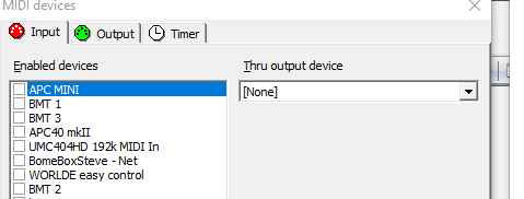

1) Ok for this. 2) I will save BMT error log for the next time. Usually, it occurs when resuming (or reopening without OS rebooting) MIDI/DAW sessions after hibernation or suspension. It is not every time, but a somewhat rare occurrence. The problem is that usually I only notice the problem after the complete setup for live performance is done. Since some months ago, I have been checking BMT error log before going on with DAW and VSTi sessions. If the error is there, I fix it (closing and reopening BMT, and/or disconnecting/reconnecting USB interface) before everything else. DAW and VSTi are Cantabile and Hauptwerk. 3) I have just uninstalled BMT v1.8.2, including manual driver removal, and installed the v1.8.3. I have set one virtual port up only. Windows Device Management lists “Bome MIDI Translator (1)”. With BMT v1.8.2, the virtual MIDI device is listed as “Bome MIDI Translator 1 (1)”. For the v1.8.3, the DAW and VSTi software see BMT virtual device as “Bome MIDI Translator”. Also, v1.8.3 panel lists now three Bome devices at Project Default MIDI Ports: Bome MIDI Translator 1 Virtual In (pending), Bome MIDI Translator Virtual In (open), and Bome Virtual Port 1 -> Bome MIDI Translator Virtual In. When I delete Bome MIDI Translator 1 Virtual In/Out ports, BMT recreate them on next session and asks me about routing these ports. Update: I tried to set no virtual ports on BMT configuration and then 1 virtual port. The result is a new port called ”Bome MIDI Translator 1 (2)”, which is seen by DAW/VSTi as Bome MIDI Translator 1. At least, this is an workaround until a more definite diagnostics about what’s going on. Anyway, BMT v1.8.3 is still recreating and asking for ”Bome MIDI Translator Virtual” routing when opening my custom project. Update 2: I have discovered a little strange thing on MIDI Router panel. After opening my project, and being the option ”Only display open MIDI ports” already ticked, if I turn this option off and then back on, then it comes ”Bome Virtual Port 1” in the IN and OUT columns. What’s the correct behavior? ”Bome Virtual Port 1” ports being listed among ”1 Virtual” ones, or the otherwise? And what’s the difference between these two pair of ports? Are they redundant?

Thanks, Steve, for your prompt reply. If I’m correct, the behavior of creating a virtual device named “Bome MIDI Translator” instead of “Bome MIDI Translator 1” was really intended for the BMT v1.8.3 release? Also, could you please explain the difference between “Bome Virtual Port 1” (IN or OUT) and “Bome MIDI Translator 1 Virtual” (IN or OUT)?
2018-06-08 16:08:18
If you set up your virtual MIDI ports for short names, all other applications will see the virtual ports as BMT 1, BMT 2 .. etc.
If you set up your virtual ports for long names, all other applications will see your virtual ports as Bome MIDI Translator 1, Bome MIDI Translator 2 etc.
In both cases, this is the EXTERNAL name recognized by OTHER applications.
Within MT Pro,  you will see the input port names as Bome MIDI Translator 1 Virtual In  etc.  Output port names will be Bome MIDI Translator 1 Virtual Out etc.
You can also set up aliases within MT Pro to give them any name you want.
On my system I have Bome Virtual Port 1 as an alias to Bome MIDI Translator 1 In.
