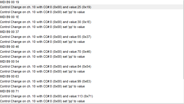

and when I move my fader on the BCF2000 is the following
B9 00 19
Control Change on ch. 10 with CC#.0 (0x00) and value:25 (0x19)
Control Change on ch. 10 with CC#0. (0x00) set “pp” to value
how can I changue the RAW midi coming from GMA2 to a CC going to back to the BCF2000?

2018-06-12 14:30:40
OK, GrandMA2 documents the Sysex format at the following link as an MSC Command:
https://help2.malighting.com/Page/grandMA2/remote_control_msc/en/3.3
From what I read Input should be
MIDI IN Raw : F0 7F 70 02 7F 06 pp qq rr tt F7
Rules:
// pp= fader number qq=page number, rr=fine tune, tt=course tune
// fader from BCF2000 are on channel 10 so MIDI Command should be B9
// CC for fader 1 is 0 so we will use pp for that
// qq is page number so we won’t use that
// rr is fine tune and we don’t have more than 128 precision so we won’t use that
// tt is course tune we will use that for the fader’s value
Output: B9 pp tt
Please give that a try and see what happens.
