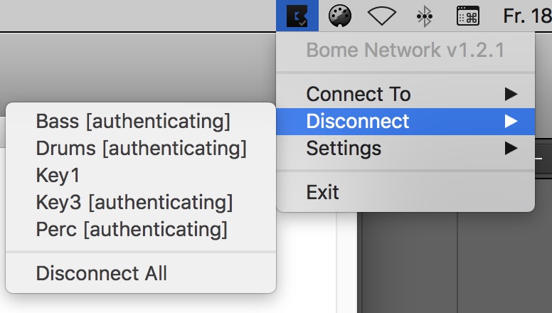

2018-09-15 07:48:34
Here ist the log file. This time, only one Mac was automatically re-connected (Key 1). See attached screenshot. The Mac that connects to the other Macs ist called “Key2” in my setup.

2018-10-25 13:59:43
Sorry for the late reply. I think the root problem is documented with this in the log:
2018-09-17 13:48:24: Bome Network MIDI Directory: Transmit error: Error transmitting message
2018-09-17 13:48:24: UDP_MIDI_Directory: vanished broadcast domain: 192.168.1.255
It seems that “Key2” got disconnected from the local network somehow. Then, all connections are treated as if they’re across networks.
We’ll investigate.
