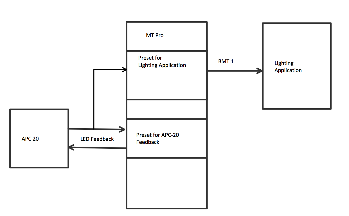

Hi! Help to set up a grand ma 2 pc and akai apc 20 to change the color of the buttons?

2018-10-04 18:28:50
This is possible. The following diagram shows how this is done. We use 2 presets.
One preset is set up for APC 20 input and GrandmMa 2 output for sending note to your lighting application.
The other preset is set up for APC 20 input and also APC 20 output to control the LED’s.
GrandMA for PC does not offer automatic feedback for LED’s however you can send note information with the midinote command as part of a macro if you wish. It is a bit cumbersome to do this for many notes which is why I recommend using MT Pro to provide the feedback.
In the Feedback preset you set up translators such as below. The example below is to toggle the on-off state of the LED each time you push the button. I recommend you put your APC-20 in note mode as GrandMA for PC does not understand incoming CC but only notes.
I also recommend if you want to send faders, you set up translators to convert fader values to note velocity. I would recommend you also put your output of faders on a different MIDI channel so as not to collide with notes of the same number.
Translator : Note 40 Toggle
