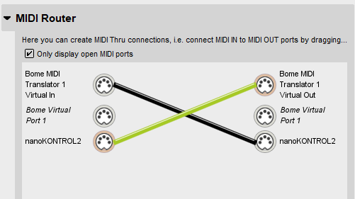

OK the picture is starting to form for me now, but’ I’m unsure of a few things.   See the below diagram.  According to the manual, the controller exposes 4 MIDI ports (2 in and 2 out). What I’m not sure of is if the second pair of ports is used in MIDI mode for control, or whether both control and performance go through the first port in MIDI mode.
Also, the manual recommends against switching between MIDI and Mackie mode during performance.  I suspect the reason for this ismay confuse many DAWs.
What you are looking for is to be able to use a control to select between the various MIDI pairs using a “shift” button, allowing you to use the same controls to handle 4 x paramaters.
Basically what you will need is a consistent control type to select among the available port pairs. Each port pair would have two presets (one for each direction) that defines the MIDI routing.  I created something for this and attached it below, however I’ve only set it up for 1 direction (out only), so you would need to modify it to handle complete pairs (to control your faders).  You would also need to have global variables to “remember” you fader positions for each selections and send fader updates when switching pairs.
Is this the type of thing you are looking for?
