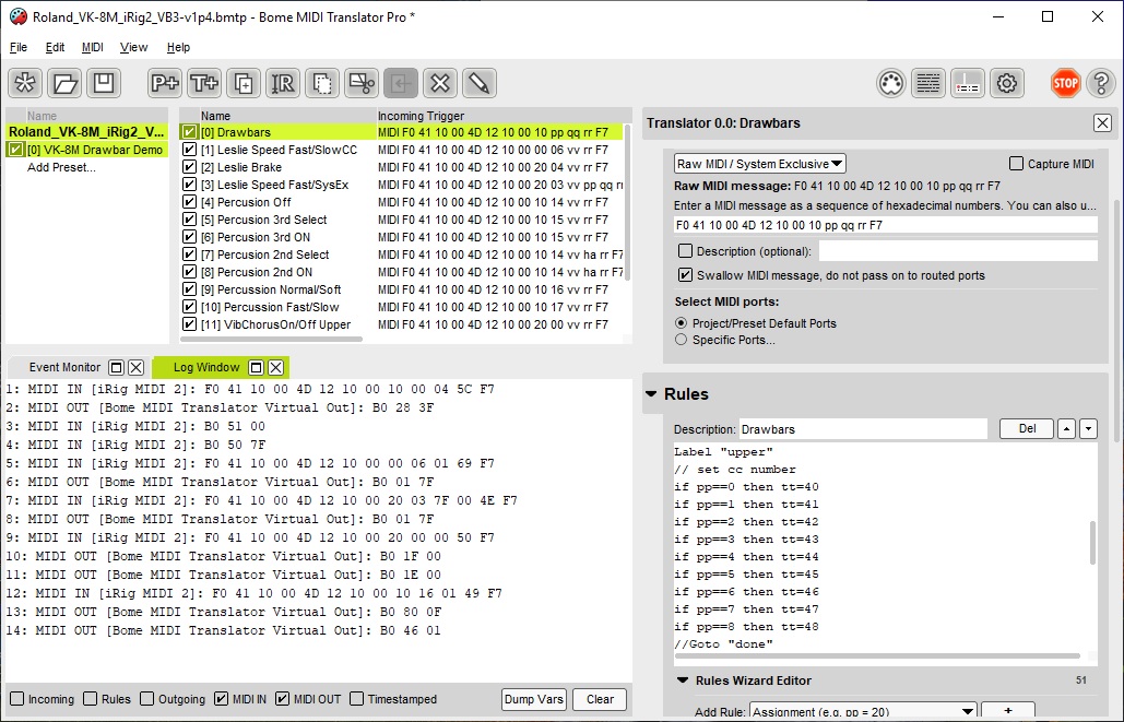

I searched for any posts on using Bome's MT to interface Roland's VK-8M module to the VB3 VST.  Didn't find any so I'm posting my experience over the weekend.
I downloaded the MT Pro trial version,  installed it, routed it to my MIDI interface's out,  with the MIDI interfaces IN connected to the VK-8M's MIDI out.   That was enough to start moving the VK-8M's controls and monitor it's MIDI out commands in MT's Log window.    I examined what was coming out of the VK-8M,  a combination of  exclusive SysEx and CC# commands,  and was able to easily program MT in about 30min to translate them and start controlling the VB3.    Yippeee!!!!! :-)    Had some help from Steve.  Thanks Steve!!!!!

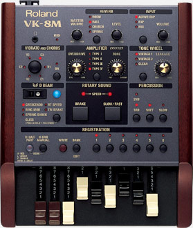

The VK-8M is a beautiful module with Hammond like drawbars and controls.  Check out the attached photo.  It does have it's own B3 sound,  but if you're a long long long time Hammond purest like me,  the VK-8M's sound is just ok.   The VB3 VST on the other hand is a monster!   It's a screaming Hammond plugin!

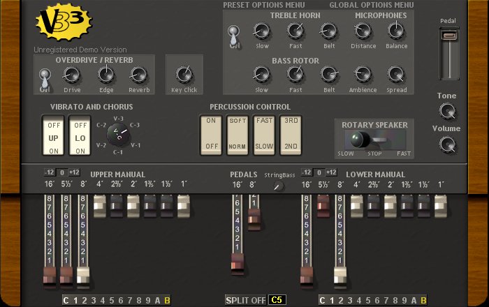

View of VB3  VST.  Definitely a great buy.  Use MT to map it to your controller.
lancearm71
2019-01-14 02:11:41
This is VB3 version 1.4 that I’m mapping to.  It’s not the latest version, but I like I like it’s panel better.  Some of the front panel knobs don’t appear in the latest version.

Do you have a VK-8M? I love it’s B3 like drawbars. A lot of controllers have sliders, but playing live you just don’t have the same control as with B3 like drawbars.
VB3 has a midi learn feature, which will work for controllers sending out CC#’s. The VK-8M however sends out short SysEx commands, which can easily be translated with Midi Translator to CC commands that VB3 understands. It’s weeeell worth the effort. Hook VB3 up in stereo and CRANK IT!!!!! Your guitarist will be jealous because you just took over the band! (And maybe the girls too! 🙂

I will post my VK-8M to VB3 file when I complete it.    I’ve had great help from the developers when I hit a couple of hurdles!!  (still have one left)    The VB3 midi implementation chart doesn’t tell all.   I’m a document freak,  so I’ll be posting a documentation file too.  You may have to modify it depending on which version of VB3 you’re using.    (I attached a screenshot of a VB3 pulldown window showing an option that had to be selected before the Leslie Brake would work)
I couldn’t have done this so fast without MT’s great log window.   The VK-8M outputs SysEx commands for every control,  so VB3’s MIDI learn feature can’t read the VK-8M.   I executed each of the VK-8M’s controls, and used MT’s log window to copy and paste them into the translators, and of course edit them.   Took advantage of the duplicating translators to speed up things.

Status update on my Roland VK-8M --> Bome --> VS3-II progress.
   Well, there are 3 versions of the VB3 VST floating around out there.  I started a Bome project that worked with the free VB3 that came with my DAW.  It worked fine.    Unfortuately not all the Roland VM-8K features have a MIDI controller# assigned to them,  some have Roland system exclusive msgs.   That's were BomeMT comes in.    The drawbars are sysEx, leslie controls are CC#,  and other pertinent Roland front panel controls do send out either SysEx or CC#'s.
  Unfortunately,  there were some CC# changes made between the 1st VB3 version and the expanded purchased version,  causing the leslie controls to not work.   I'm still trying to resolve those. (can't get stop to work)
