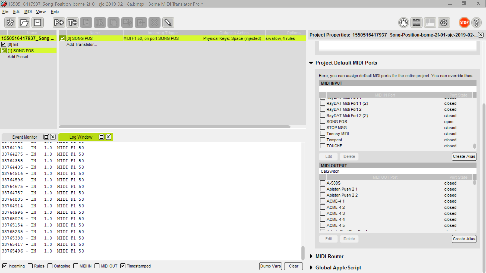

Thank you, much appreciated indeed! Here’s what happens: If I inject into Cubase, nothing happens. ( either Cubase doesn’t work with this feature this or I am doing sth wrong ) If I don’t inject, it tries to play ( attempt to jump back 1 bar for the preroll again ) but immediately jumps back to where to its original position ( beginning of the loop ) where it ultimately gets stuck. I assume this is because it sends an outgoing action at every frame, not just once, when the condition is met. >> see screencap Please forgive my ignorance here, but I am not yet at the stage in Bome where I’d be able to fully grasp your code. Would you please be so good and elaborate a bit further. Where’s the global variable set? F 50? Apart from the rules ( they’re three I understand ), is there any other code anywhere in your setup? I can’t seem to find anything else. Also, does this expression consider the varying start points of the loop as in song position?

lordExtra
2019-02-18 19:24:51
Sorry, but this forum really confuses me although it’s somehow amazing haha.
I’m slightly losing track of the chronology here. I just tried your last setup “bome-2f-01-sjc-2019-02-18.bmtp”
and it still puts out the keystroke at every frame, not sending messages when they should. I’ll attach the corresponding buffer capture…not right below but further down I guess.

lordExtra
2019-02-18 23:29:56
I assume I need to activate (esc) the timer before I hit play in Cubase, correct?
Just tested it and it doesn’t work. Same as before, the cursor jumps for preroll and right back to start.
From what I’m able to surmise is that the condition is met at every frame.
Also, the incoming midi shows F1 50 at every frame, is this intentional?
