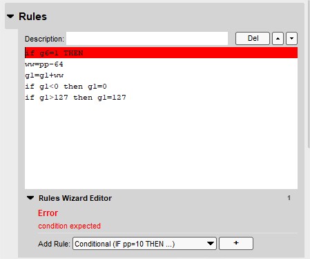

Hi, my dial has a rotary switch (relative) and a push-hat switch.
I want to program it so that: ...if I turn the dial, it does function 1 and ...if I turn the dial while pushing it down, it does function 2 instead.
I figured I could have two states for the dial which I could call with a global variable (eg., If dial is pushed, then "g6=1" and if dial is released, then g6=0").
However, when writing the rotary scripts, if I try to call the global variable (push state) by typing:
"If g6=o then...." or ""If g6=1 then...", I immediately get a syntax error.
How do I incorporate the 2 states for the dial in separate translator functions please? Thank you.

2019-02-19 16:52:58
Good job,
Yes this can also be done with variables if you don’t like the preset method but either one works just fine. That is the nice thing about MT Pro. It is powerful and can do things in different ways depending on user design.
The original reason you saw the error is that if you are looking for equality you need to use two equal signs. For assignment it is one equal sign.
For instance this works
if pp==1 then ga=1
But this will not
if pp=1 then ga=1
For the variable method you would have a translator that sets a global variable like ga to one when pushed and then to zero when released
