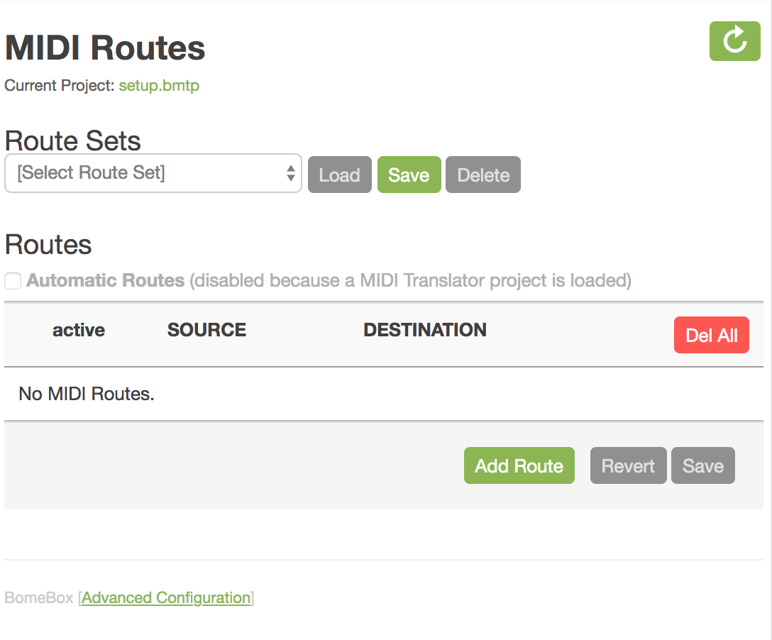

Also see my note on earlier post about assigning default MIDI through routes. If you can show a screen shot of your MIDI Routing page on your BomeBox (with 1.4 loaded). We might be able to figure it out. If I remember in the last project file you posted, you had default ports set in your project file but not default routes. I’m pretty sure in the new 1.4 version any default routing in your BomeBox gets overridden by your running project file.

natanael.cognac
2019-04-04 22:32:18
This is the routing page.
2019-04-04 23:13:12
OK, I’ve had a look of your project file. Very good job by the way. You must have been paying very close attention to the tutorials.
The only thing I noticed is that when opening the file, all Acc presets are off, so you will not get any output until you hit your foot pedal. I would recommend that you have the INIT timer turn on one of them by default. While you are at it, you might want to turn on the “All Notes Off Acc” preset with INIT too just in case you inadvertently clear it before closing a project file.
