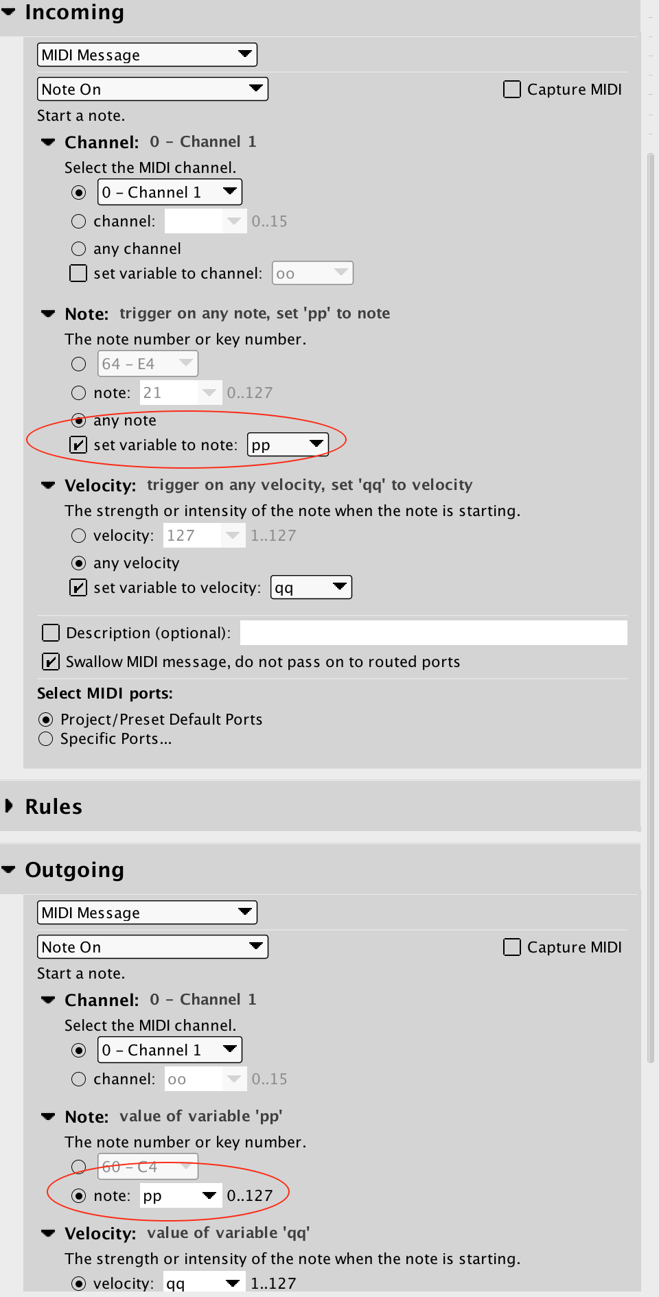

natanael.cognac
2019-04-05 13:50:09
Here is a screenshot. Note I also pass the variable for the velocity.
If this works for you, then you can deal afterwards with the sustain pedal. You’ll have to create 4 new translators that take the sustain pedal from channel 1 and distribute it to the channel 1, 2, 3 & 4.
Just this time the midi message will be Control Change 64 (you also have to pass the value in a variable).
It seems a lot of work at first, but once you understand it, it can go very fast.

yamahaqs300
2019-04-05 18:32:46
Thank you very very much !!! Works perfect ! This software is brilliant,and you guys .
