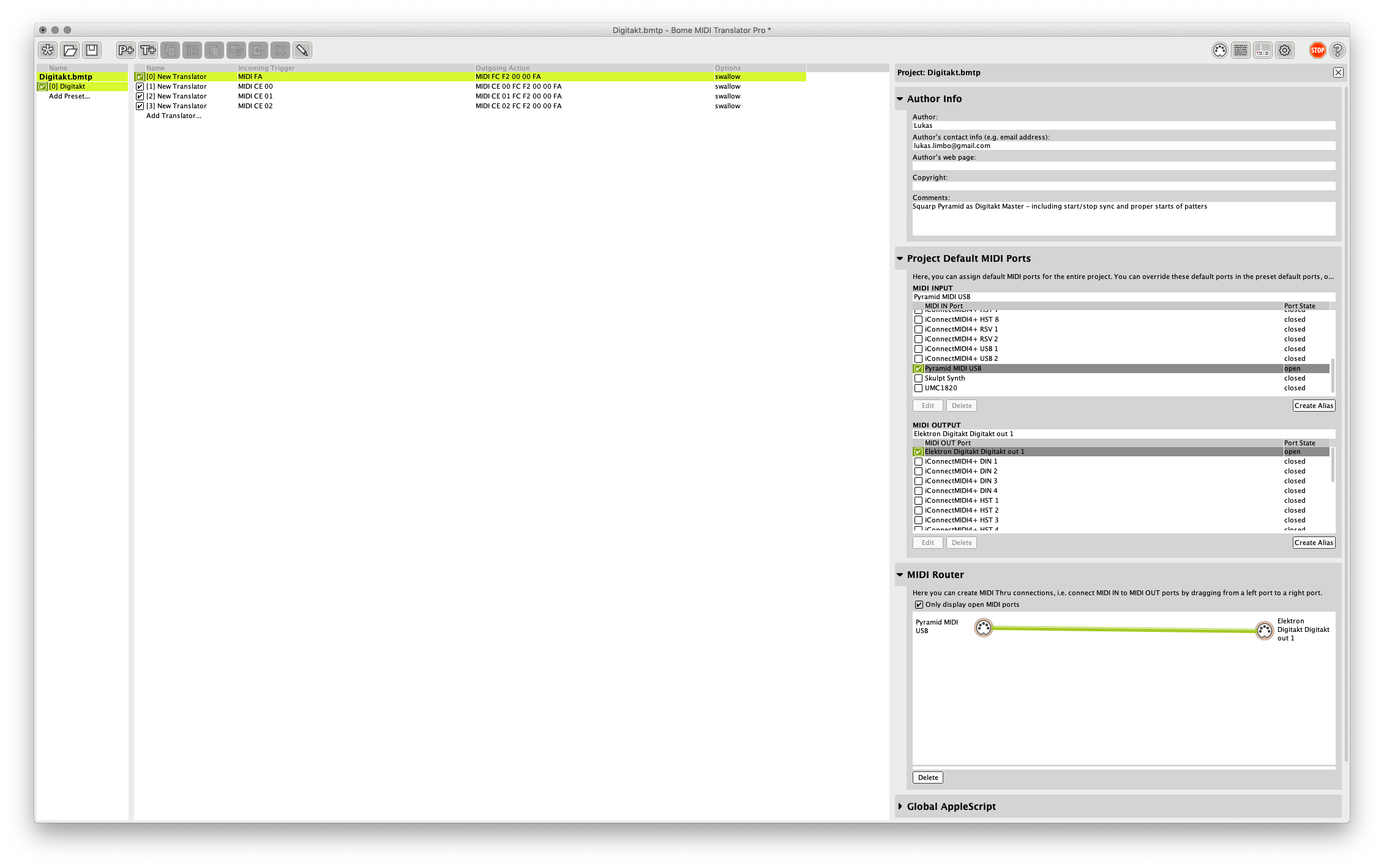

firstly, thank you both for your answers.I am playing with that for more than week now, it seems I am step further, but still not working as desired. I was able to get it work when I use Midi translator on my mac and both devices are connected to computer – not to Bomebox (please see screenshots how I programmed it, it’s probably not the best code, but it works). I use midi channel 15 for this connection exclusively. Sequence starts immediately and changing patters are managed by Pyramid sequence as I wanted. HOWEVER, when I load THE SAME project to Bomebox and connect both devices to USB hub plugged to BB, it’s completely broken.I checked multiple times if I have proper midi routing (through aliases I created in Midi translator) – no luck at all, Digitakt lives its own life. I checked also NRPN possibility as you’ve mentioned, but cannot figure it out for now. I will appreciate any further hints, thanks for great support.

Hi, could you tell me what version of BomeBox Firmware you are using? If not 1.4.1, then please download it and upgrade. https://download.bomeloft.com/bomebox_firmware_1.4.1.bxfw A way to troubleshoot it is to Create an Alias for your Digitak, assign the alias to Bome Network Port of your Mac, and then use MT Pro on your Mac with logging turned on to see if anything is coming through on the log file. I know that there were a few intermittant routing problems with BomeBox firmware prior to 1.4.1. Steve Caldwell Bome Q and A Moderator and Independent Bome Consultant/Specialist bome@sniz.biz Another thought is on MT Pro, it looks like Elektron Digitak is defined as Elektron Digitak out 1 and on BomeBox it is defined as Elektron Digitak USB. Please make sure that your project on BomeBox is not really trying to send to Elektron Digitak out1. Maybe it thinks this is an alias.
