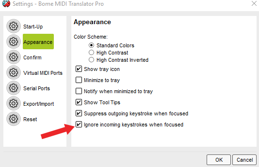

You should ensure that MT Pro application does not have focus so that incoming keystrokes are not suppressed.
You can change this behavior in View->Settings->Apperance. See attached screenshot
Also it is important that your application NOT have focus if you don’t want it to see the original keystroke. Original Incoming computer keystrokes are never suppressed by MIDI Translator Pro going to the Operating System and applications (except MT Pro itself).

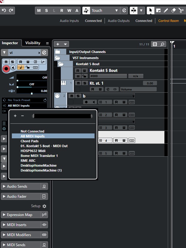

I suggest you set input of Cubase to Bome MIDI Translator 1 only.

-by the same token, setting the midi input in Cubase to MBT1 only precludes my playing that actual instrument while I send the commands.. ?
