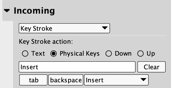

I'm using a numerical keypad to change midi channel on my seaboard block. Everythings works just fine except that the "Num 1" is not recognized as Num 1, but as insert.
I've tested my keypad on different applications, and it is only in Midi translator Pro that it is not recognized as the correct key.
I didn't find an other way to put the keystroke into my little script.
So I don't know what to do in order to get that " Num 1 " keystroke.
Thanks for your help.

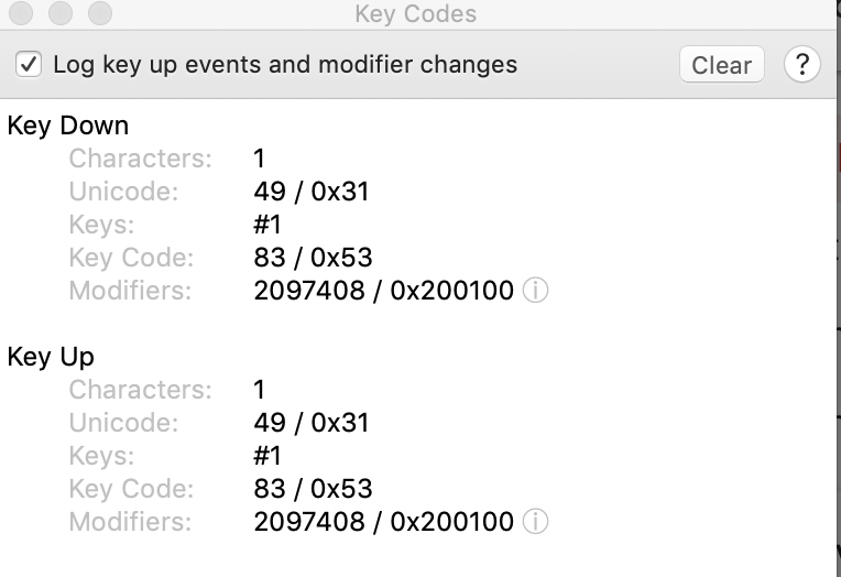

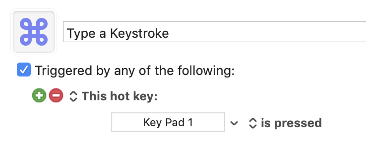

I was able to duplicate this with my Logitech extended keyboard attached to my MacBook Pro.
When entering Num 1 into Keyboard Maestro, or Apples Keystroke evaluator tool, it appears as Num 1.  When entering into Bome MIDI Transport it appears as Insert.
I’ve filed a bug report as I believe the scan code recognized in Bome MIDI translator is incorrect. My guess is it should still work but not display the correct incoming keystroke.
