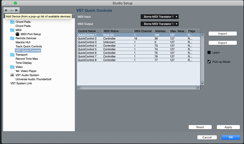

Cubase quick controls doesn’t actually use Mackie Control or HUI. Its a set of 8 controllers that can quickly be set to control anything in Cubase. Cubase allows you to set a hardwire controller for these quick controls. I attached a screenshot.
I can manually enter what message is coming in. When I use “Learn” mode it automatically thinks its a note on message which I assume is me touching the fader rather than the pitch bend from moving the fader.

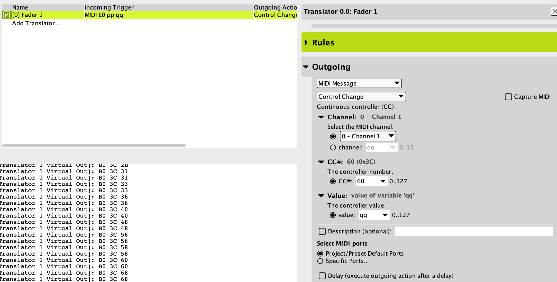

2019-09-03 23:00:17
Try setting the output of Translator 0.0 to qq insteand of pp. See screenshot lower right area. On your version it will say pp.
Can you use the MIDI translator log to see what is coming back from Cubase when you move the control within Cubase?

2019-09-03 23:24:07
This is coming from your quick control? If so, you need to relearn it. It looks like your quick control is also sending pitch bend.
