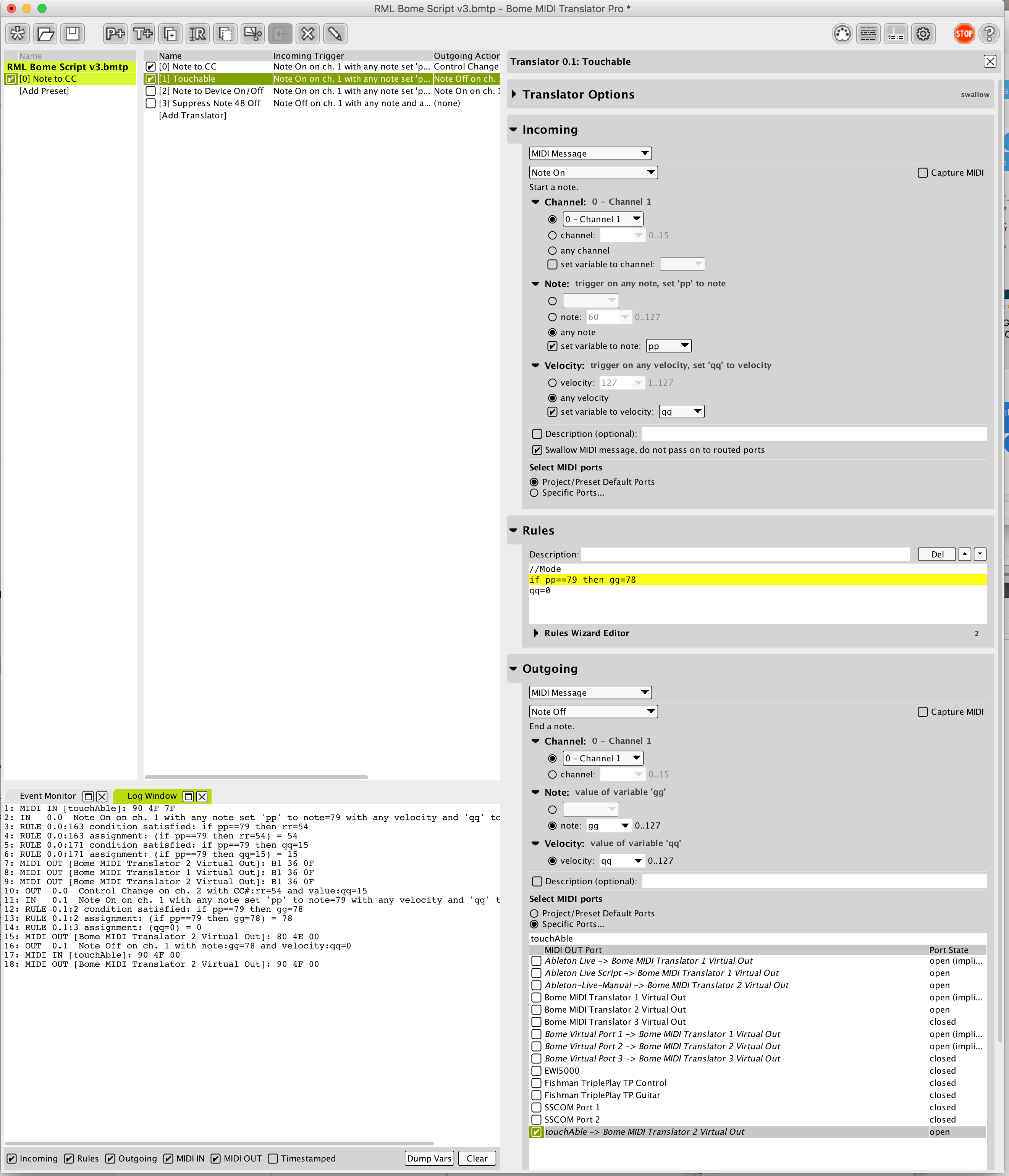

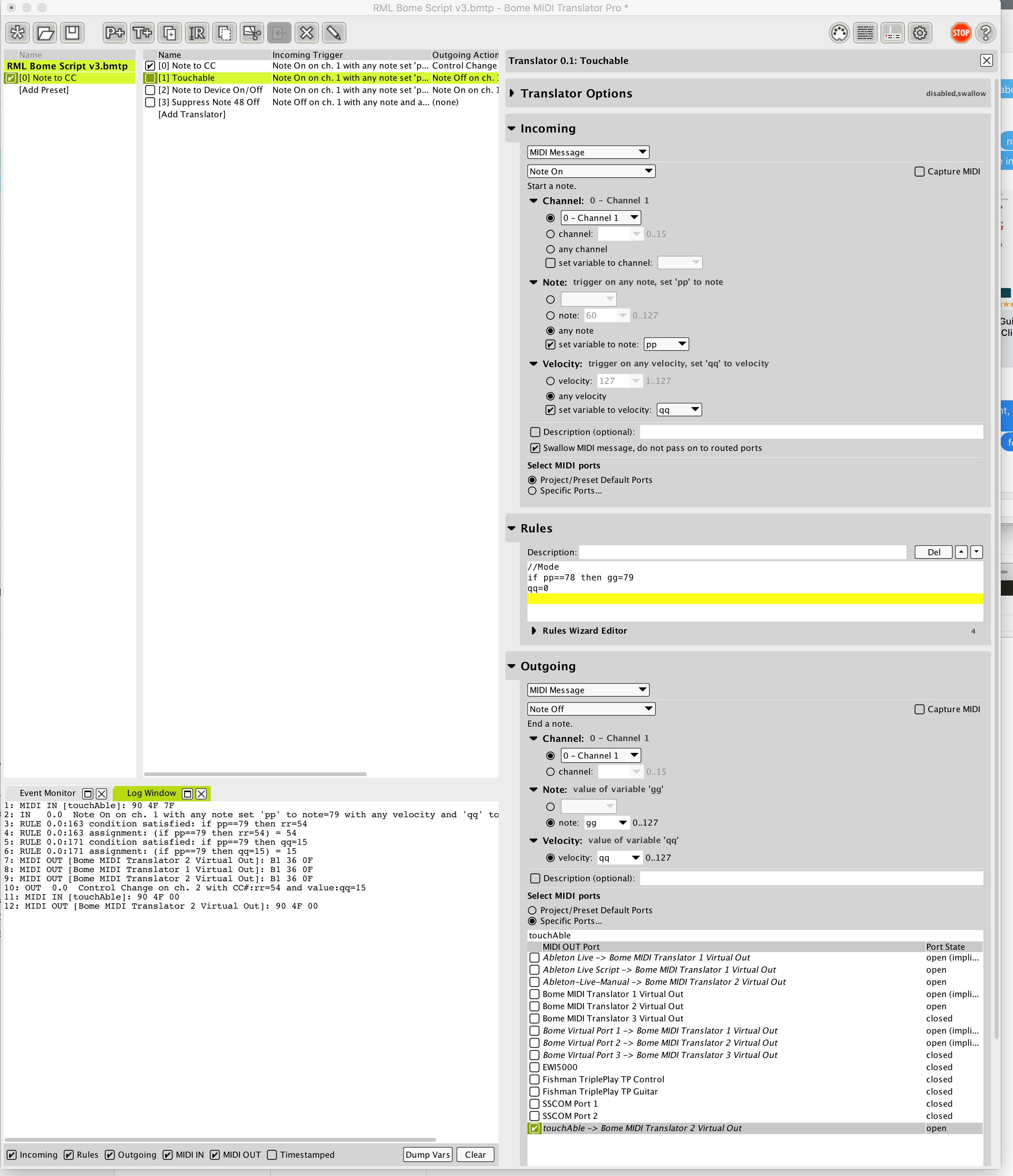

The project is nearly finished, and hoping to solve this one last bit with your assistance. I did attempt this before writing you, but failed (see below).
Let's say I have two touchable latch buttons -- and #1 is currently on, and #2 is currently off.  If I press Touchable latch button #2, I'd like to send a virtual button press to #1 so that it turns off -- without #1 sending the results of the #1 virtual button press back to Ableton Live.
So let's say #1 is note 78 and #2 is note 79...
if pp==79 then gg=78, qq=0
send out gg and qq to touchable to turn off button #1.
Attached file shows what happened (ignore first screen shot 7.44.09 in favor of 7.47.10).
Can this be done?

Repeating the objective here for convenience, what I am trying to do is turn a latched Touchable button off if another button is pressed.  I’ve set up a second translator with the following code (I’ll move it out to a separate preset later after I get it working):
if pp==79 then pp=78
if pp==79 then qq=0
What is says is: if button #2 is pressed (pp==79), then set pp equal to the note # for button #1 (pp=78), and set the velocity for button #1 to 0.  Then Outgoing midi message is to the specific port touchAble -> BMT 2 VO.
Touchable is not responding.  Attached is the bmtp file (take v5, ignore v4).  Any thoughts on why this might not be working?
Many thanks!
RML Bome Script v4.bmtp
RML Bome Script v5.bmtp
