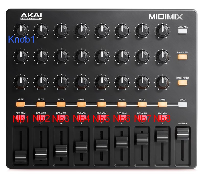

I wanna do 3 Things with the MT pro.
1. Change Channels with the switcher like you see in my project and I wrote an example in the first answer. (I have solved this thing and runs to 100% perfect)
2. After changing channels coming back to the last saved knob value. (You explained it with “crossover” or “Takeover”)
Example:
If I touch my note  from my MIDImix “Nb2” I come to channel 2 (you can see in the Picture below)
The knob 1 I put to “value 20”
Now I touch “Nb3” come to channel 3, put the same physicaly knob to “value 100”
If I go back to channel2 with touch the “Nb2” I wanna the react of knob 1 first on reaching value 20. (Like the “crossover” or “takeover” technique I think?
My Problem is, I can`t bring this to run perfect and don`t understand where I have to bring the global variable. It would be amazing to make an example on my project, to resolve this poblem.
I have learned some good things about the program, but don`t find for this a resolution.
(3. Thing is to bring the notes Nb1 till Nb8 to light on/off, if they in use/not in use, but this is another problem yet)
Kind regards
Mike

MikeDoor
2019-10-15 12:48:17
Hey,
Yeah! I have checked up my MIDImix and with your example template “Channel-Switch-Takeup”
My MIDImix could use variable Values with the same knob on other channels. (like takeover, dynamic range value)
But in my project with Channel switch, it can`t run this and don`t understand why.
Maybe the problem is that I used the same global variable for the “knob1” on channel2 and channel3.
Another fact is, if I don`t use MT pro, I only can be on this channel, where I edited on the Editor from MIDImix.
I can`t switch between the channels with a note/knob or whatever without MT pro or without the Editor from AKAI.
If I use MT pro, I made it clearly and fast to change the channels in between. (using my switcher template from my project)
Yeah! I want with MT pro and my MIDImix use – 8Channels with 24 different knobs and 9 different Fader
to use, instantly with uniquely modify their output. (I have mastered this one, but without the dynamic range of value per knob and channel)
So we come to 33 different values per channel. We would have 264 commands and variables for the value. With dynamic range values from each channel and each knob/fader.
The Nb1 button do for now, deactivate every switcher/channel in my MT pro project. Like beeing the standard saved preset from MIDImix channel (I could change it only in the MIDImix Editor from AKAI).
Normally it should be the command for the “Solo” button on the MIDImix on the right side. But the “SOLO” button has a insert programmed “SHIFT-Key-Mode” for the “MUTE” line and I don`t know, how to block this till now, for doing this process what the “Nb1” command does.
MIDImix has on the right side some buttons called, “Bank left”, “Bank right”, “Send all”.
These buttons didn`t run correctly. So they can be used for MT pro, too. To program for a better thing.
I`ll be with you, to seperate the threads. If you think we have to other threads for this problem. Maybe specific it with MIDImix?
kind regards
Mike
