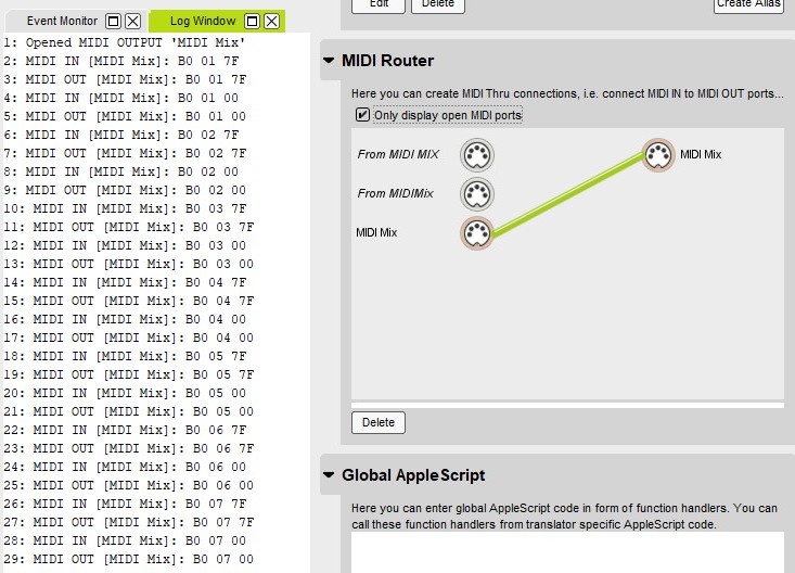

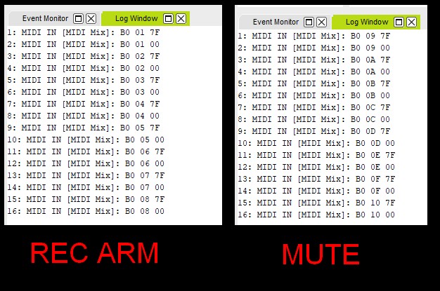

Hi, could you turn on logging in MT pro select MIDI in and push and release each of the buttons you want to control channels. Then show me the log? Also, if you create a loop back to your controller, with MT pro using MIDI thru routing, does the LED go on when pushed and off when released?
You should be able to use the attached project file for this. Just assign both input and output to your MIDI Mix.

Hey Steve,
also the lights didn`t react on it. Did it with your instructions nothing happens. Only they react on the midi monitor from the “MIDIox” software.

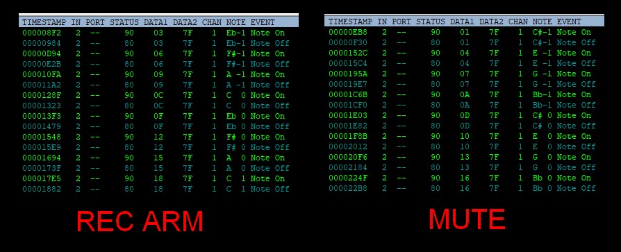

Show me what MIDI OX sends then.
MikeDoor
2019-10-15 22:06:14
Here are the MIDIox sends.
And the lights are constantly on after push the buttons.
2019-10-15 22:19:20
Different incoming messages for MIDI OX as for MT Pro. What happens with MIDI OX is you send CC instead of note to MIDI OX?

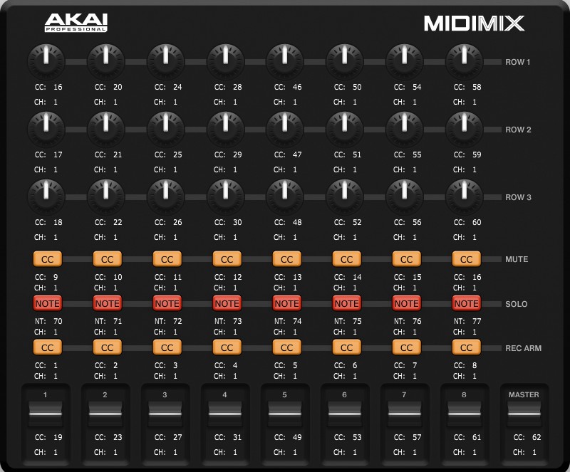

Okey, you got me again.
On the MT pro I had my MIDImix buttons with CC not with NOTE.
MIDIox has got the buttons in NOTE not in CC. Can´t understand why this is there reseted, but equal.
Now, I tested the same thing on MT pro, now the lights go, after doing MIDI thru (MIDImix to MIDImix) and stay on after disconnect from usb hub.

No. The Midimix is reseted . So all buttons are notes and aren’t CCs
