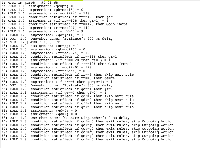

	Alright Steve, I apologize, but Im still not getting it to work. I have attached an image of what my rules progression looks like in the Log Window. But Im not sure whats going on. If you look at the bottom 1.3-1.8 all say to exit rules and skip outgoing. So Im not getting an output. Any input would be most helpful. This is exactly what I need… I just can’t make it work :/
		2019-10-22 03:24:12
Yes, it appears that the Akai APC-MINI as well as the LPD8 sends note-off messages with velocity 7F which is really odd.  I modified the rules within the 3 Byte Pedal Press translator to accommodate this change. See  attached.
Just replace the entire rules with what I have in the attached by copy and paste.
I’m also including an update project file with the new rules already loaded.
