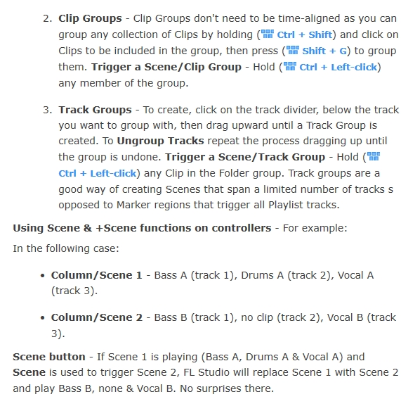

I have find out to solve the problem with the "clip launches" and "stop clip scene" etc.
Example:
I need the (ALT_GR) keystroke and the left mouse click together on:
Note on - Pad CC32 by press Note on CC82.
I`ve tried the following messages:
On one preset I did two translators,
Translator 1: Incoming - Note on CC82 -  Outgoing - the Keystroke ALT_GR
Translator 2: Incoming - Note on CC82 - Outgoing - Mouseclick left button
Normally they should be hold on, if I hold the Note CC82 but they didn`t react.
Tried with keystroke ALT_GR - down and repeat it, but after try to change the keystroke to up. The down repeater can only be stop by restart my PC....
How can I solve this with fusion a keystroke and mouse click button like:
(Hold) CTRL + (Click) left mouse button?

I`ve tried to reconstruct a “Scene Clip Launch” with normally used keystroke and mouse, but have to say that this didn`t works how I wanted.
Yeah! The Preset with the translators did this, what it should and runs okey. Only with the holded key, which have to be pressed seperate on the keyboard you explained.
I really don`t know, how I can get the “Clip Launch” used BMT…..
