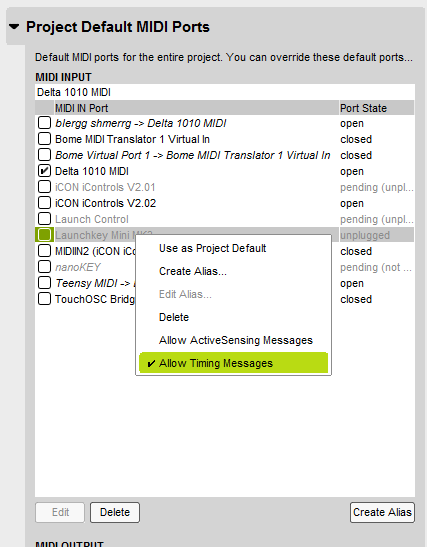

…and now I have found the “Allow Timing Messages” option in the right-click menu of the port alias! (and disabled it)

Hi, as you already discovered you can modify the behavior of capture MIDI with the gear icon.
You can also completely disable incoming timing clock messages by right clicking the input port and then unchecking Allow Timing Messages with a left click.  Doing this will also disable the messages from reaching the Event monitor or anything else within MT Pro.
