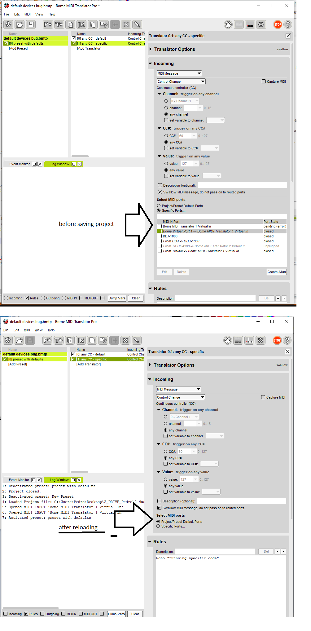

entries/presets allow to specify other devices to override the project/preset defaults. That works fine. issue is when the list is empty; I expect that no code would run, but the default device list is run instead.
Please see the below picture and BMPT, I could not atach this to the bug report web page.

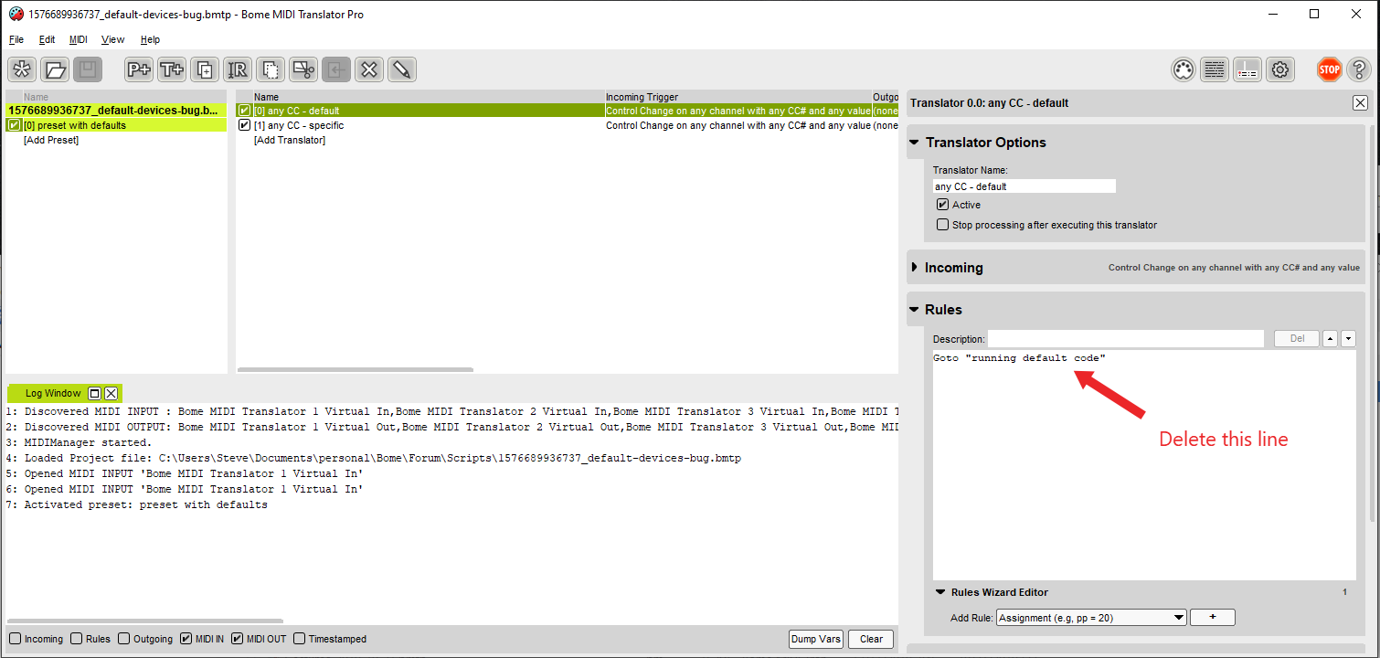

Hi, in the rules of your translators you have the following rules:
0.0 – Goto “running default code”
0.1  – Goto “runnning specific code”
However you do not have any corresponding labels within the rules.
0.0 – Label “running default code”
0.1 – Label “runnning specific code”
This is why you see the error messages.
Since you have no other rules, you should be able to just delete the goto lines
The source and destinations can be set at the project, preset or translator level as indicated in this tutorial.
Preset level destinations override project level destination. Translator level destinations override everything.

a) The “gotos” are not errors. They are just a poor man debug printf.
b) seleting an entry override, not selecting any devices on purpose, saving and reloading the project moves the entry back to default. That is my issue.

now the attacmenet. I had to try several times until I managed to upload this
pedro.estrela
2019-12-18 23:28:38
please see above the picture and comment
2019-12-18 23:59:37
Ah, a debugging technique. Never thought about using that.  Anyway, if you don’t select an override, then it will go to the default ports indeed but will still run. If you don’t want to run the translator, rather you need to either disable the preset (which will disable all translators within, or disable the translator itself by clicking the checkbox at the left until the check mark disappears.  You can disable presets also through outgoing actions of translators. You cannot do this however disable translators this way, however. Yet you can change a variable and then have a rule as the first rule to check and see if the variable is a given value and then abort the rest of the translator that way.
