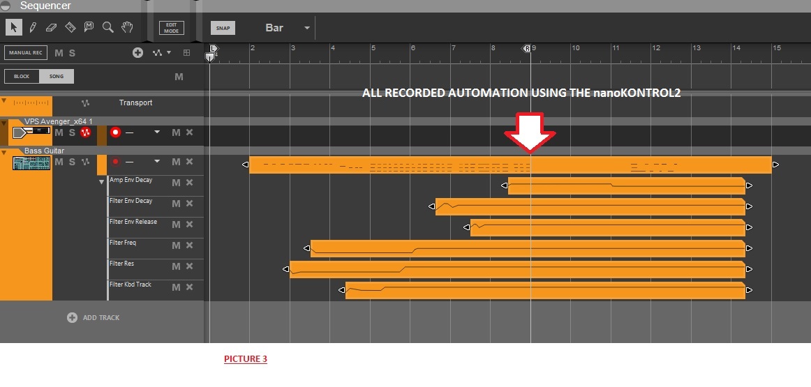

So far I have the nanoKONTROL2 working well in Reason Daw mode - and I have successfully set it up using all the standard Reason Instruments controlling and recording automation (attached picture 3) and also to control lots of Avenger VST parameters via remote mode. But these do not get recorded in Automation mode which is what I want.
