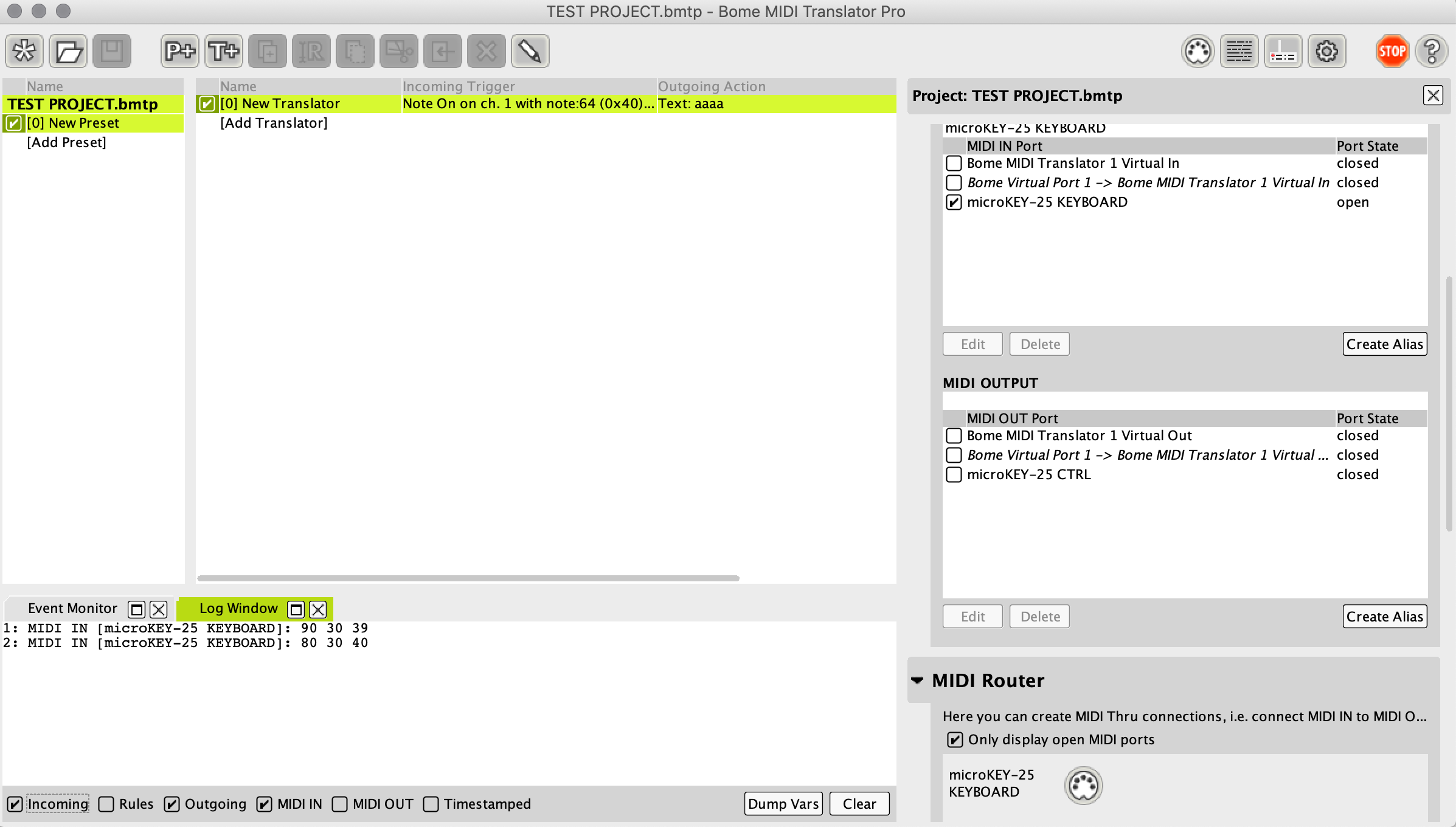

Hi, do you see anything in the log window? Could you show me a screenshot of the log window with MIDI IN, Incoming and Outgoing checked after you have pushed the input button you are using to trigger the event? It is easier to tell what is going on with the log view than the event view.

here's a screen shot of triggering midi controller
2020-02-06 15:36:22
OK, since you see MIDI IN but no Incoming, it looks like the incoming message does not match the condition as set in the translator, I can't tell since I cant see the entire translator but perhaps either the channel or the value of the button you are pressing does not match. Please modify the translator so that the incoming trigger matches what your button sends. If you want note on at any velocity set it to ANY. Then in should work.

Thanks for your time on solving this. You were right in identifying that my note selection in the translator did not match my midi input.

Glad to help. This is a common issue. I've been bit by this one before. Best to always look at Incoming and MIDI IN. If you see MIDI IN but no Incoming then the trigger is wrong (that is if the trigger is MIDI) Steve Caldwell Bome Q and A Moderator and Independent Bome Consultant/Specialist bome@sniz.biz
