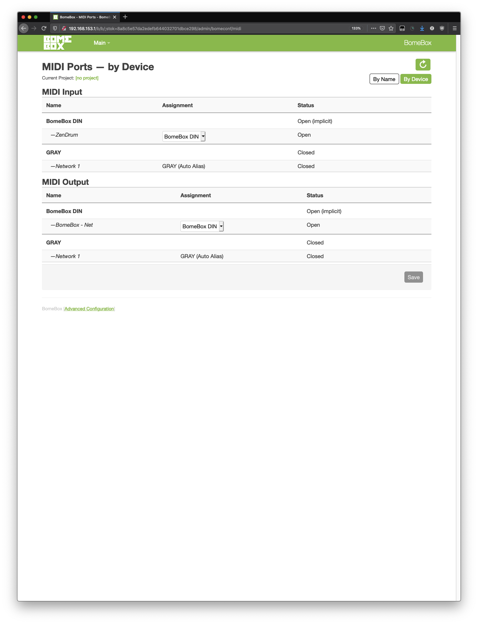

I got it to work again. It seems that, at one point, the MIDI Ports page started letting me make choices after I uploaded a toy project. When I went back to the real one, it was working, and the BomeBox DIN output no longer showed as closed. I'm attaching a screenshot of that page--it's correct, right?
The question is: what might have thrown things off in the first place? All I did was a minor tweak, then suddenly the output DIN can't be opened. Can the port settings suddenly get hosed from some sort of bad communication? I hope I don't have to just write this off as bad WiFi conditions again. At this point, the BomeBox is sitting on top of stuff, three feet from the computer, which has line of sight to the box. I do have that latency issue when using BMTP, which isn't a terribly big deal in my case, but is it possible my BomeBox's WiFi isn't up to standard? I really don't see how my environment's WiFi is much different from other studios'. Is there a specific quality test for the BomeBox's hotspot?

I don't remember ever seeing a situation where the DIN ports showed closed. Did you see that as well? I assume you are using the latest version of BomeBox firmware. 1.4.1

Yes, the MIDI Output BomeBox DIN showed "closed," and there was no active dropdown menu. I just re-verified that firmware is 1.4.1.
2020-02-28 16:32:56
The only time I think the DIN port would show closed is if you have a project that is not using it. I just tested this with a project that I have that doesn't use the DIN port.

I only have the one project, and in my setup I'll always use that DIN. In fact, due to the latency problem over WiFi, I'll never be able to use my BomeBox with software modules.
2020-02-28 16:39:49
Also, if your alias is not-assigned or not assigned to the MIDI DIN port, the MIDI DIN port would also show closed. When you close any projects it should show open again which is the default configuration if no projects are loaded.

2) MIDI DIN port closed
As Steve has pointed out, this is only the case when the DIN port is not used by MIDI routes or the translation project file. So if you also found that the project file got unloaded, then I assume that the closed DIN port is just a symptom rather than the cause. Because when the project is unloaded, the DIN port is likely to not be in use anymore, and therefore it's getting closed. On a side note, the BomeBox only opens the MIDI ports (network, DIN, and USB) when needed in order to use less power.
Another aspect is that your project file does not define the BomeBox DIN port directly rather, you have defined 2 aliases ("BomeBox - Net" and "ZenDrum") and I assume that you then assign one of them to the BomeBox DIN port. The BomeBox remembers these port assignments in the same way as it remembers the currently loaded project file. Now if we assume that somehow saving these settings fails (or loading), then it would also explain why the MIDI port assignment gets lost. See next point.

When I'm running BMT, should I just select "BomeBox - Net" in both the MIDI Input and MIDI Output sections?
2020-05-23 19:10:27
Hi, I can understand your frustration, however if ports and/or aliases are not defined in your project file, you will ALWAYS be prompted for them when you reload your project.
I haven't analyzed the files to your intent so at the project level, I recommend you set up and check aliases for "all ports" that you will be using. Then override as appropriate at the preset and translator level depending on your desired routing.  Always use aliases an not real port names as your project file will not be portable between  your computer and BomeBox if you do not. Also always use aliases that are not "auto assigned" by BomeBox.
I hope this helps!
blipson
2020-05-23 19:21:08
To be honest, I don\'t fully understand what you mean. Can you spell it out in gory detail or recipe format? Sorry about this--I\'m not a total dummy because, as you can see, I\'ve put together detailed patches, but somehow I just don\'t seem to get this MIDI routing issue. Doing what I\'ve done, I\'m able to test while using BMT (though I have that latency issue), and then transfer to the Bome Box, where everything continues to work as expected, except for that power cycling issue. Since everything basically works, I don\'t understand what I\'m not doing right. It sounds like you\'re implying that getting the MIDI configuration issue correct in BMT may fix the power cycling problem, so I\'m asking for a n00b-level explanation. Can you edit my bmtp file and send it to me?
2020-05-23 19:30:20
When a project is loaded on BomeBox, it first looks for all real ports assigned and tries to assign them. However it is most often the case that the real ports on BomeBox are not the same real ports on MT Pro. This is where aliases come in.
So once BomeBox assigns any real ports it looks to see what is left and assumes they are aliases. If the aliases are previously known, it just re-assigns them based on the last loaded configuration.  Keep in mind that if you have multiple projects that use the same aliases with different assignments, BomeBox may assign them wrong.
If it cannot find an alias, it prompts you to assign it in the configuration screen you showed me. That assignment should be persistent across re-starts. Keep in mind, that if you use a different project file, with the same aliases and different assignments, it may assign them incorrectly so it is best to keep your project file aliases different unless you always want to assign the aliases the same.
There are some auto-aliases assigned by BomeBox for network ports.  For instance if you have a BomeBox called "BomeBox1" on your network, it will be assigned "BomeBox1 - Net".  You should avoid using these alias names and treat them more like "real port names".
As far as your project file, let me know the real names of the input an output ports you want to use and an alias name you want to assign it at all level, and I can update the project file accordingly.
blipson
2020-05-23 20:08:51
My input port is the Bome Box's MIDI in DIN, and my output port is the Bome Box's MIDI out DIN. I will only ever have one project file. I would like to assign the name "ThisIsTheCorrectPortToSelectPerSteve" to the correct port to select.
2020-05-24 01:56:36
Here is the project file.
Again, you will be prompted to assign these aliases the first time you load it on BomeBox.  After that it should remember the former assignments unless you change them again.
Axis-P23-TD50-sjc.bmtp
blipson
2020-05-24 02:04:36
I've downloaded and opened it in BMT. I should now simply assign both in and out to "BomeBox - Net"?
2020-05-24 02:25:07
Yes if running on your PC, however if running on BomeBox since you are using MIDI DIN ports assign them to your MIDI DIN ports instead.
blipson
2020-05-24 02:31:24
That was my toy file. I believe I've now made the necessary change to my production file, which I've attached here. Can you please verify?
Axis-P23-TD50.bmtp
2020-05-24 02:37:55
No, you need to go through the entire project file at the project, preset and translator level and change any reference from "BomeBox - Net" to "ThisIsTheCorrectPortToSelectPerSteve".  Uncheck any Boxes that show "BomeBox -Net" and instead check the boxes "ThisIsTheCorrectPortToSelectPerSteve"
See the below video for how to manage your inputs and outputs at project, preset and translator level.
Tutorial
blipson
2020-05-24 02:57:05
I've watched the tutorial, and I think I'm starting to understand where I've gone wrong with the MIDI routes stuff. However, may I please n00b-out one more time and ask you to add the "ThisIsTheCorrectPortToSelectPerSteve" to my production file that I've now cleaned up and attached?
I'm asking for hand-holding here because 1) I won't fully understand the tutorial for a while; 2) I think this will be a once-and-for-all-time solution because my Bome Box has only ever been dedicated to adapting one controller's (Zendrum's) velocity response to my sound modules; and 3) based on experience, I wouldn't be able to rule out the power cycle issue for days to months, and I don't want the toy file to block me from using my stuff if that's not necessary.
Axis-P23-TD50.bmtp
blipson
2020-05-24 12:07:07
OK, here\'s what I\'ve done.
1) I went through every patch to make sure it selected only default MIDI ports.
2) I loaded your version of the toy project, and BMT prompted me to assign the ThisIsTheCorrectPortToSelectPerSteve alias. For both input and output, I assigned it to \"BomeBox - Net.\" That created the alias, which is now available in BMT regardless of which project I load. My earlier problem of not being able to delete an alias was apparently because the old alias had been created on two different computers. I\'d deleted it on one, but not the other, so it had to be deleted twice. I didn\'t realize these aliases are BMT\'s and not the project file\'s.
3) I went to the Project Properties page and  selected ThisIsTheCorrectPortToSelectPerSteve for both input and output.
4) In all my time with BMT, I\'ve never changed--or even thought of changing-any translator from its default choice of MIDI ports, but I went through every translator in every patch to verify that each one selects \"Project/Preset Default Ports\" for both input and output. This was not applicable in the case of patches involving only the USB keyboard. I scrolled through fast, but I expect I didn\'t miss anything because, as I said, I\'ve never ever made a change here in any translator.
5)  I uploaded to the Bome Box, selected, and assigned \"ThisIsTheCorrectPortToSelectPerSteve\" to \"BomeBox DIN\" for input and output.
Everything works as expected, but that doesn\'t mean the problem is solved. We\'ll now see if the configuration file gets loaded at each power cycle. I do verify that the WiFi latency problem continues as it always has. It could be hours to months to verify the power cycling issue. If it survives the first power cycle (as I\'ve now verified that it has), then that has always implied that it will continue to work at least until some change is made to the project file, and I might not be making any changes for a while. Even then, the failure-to-reload-on-boot problem has only ever begun suddenly--the first time after two months--but once it happens, it continues to occur on virtually all subsequent power cycles, making the problem intractable.
I\'ve attached my current project file for you to look over. If it\'s OK, I apparently don\'t need you to edit the one above for me.
Axis-P23-TD50_202005241800.bmtp
2020-05-24 18:45:05
Good Job! I believe this will fix your problem.
