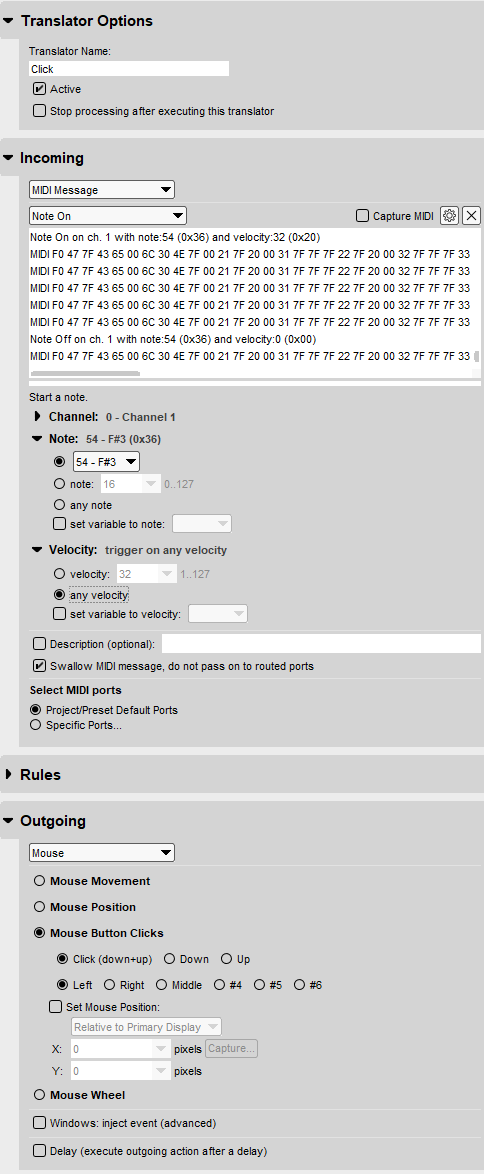

Thanks for your response. I\'ve got it mapped like you\'ve said but I can\'t seem to get translators to properly activate. I can see in Event Monitor that the Midi In and Router Out light up when i press a note so I used \"Capture Midi\" to create a simple outgoing Mouse left-click rule on any velocity but it doesn\'t seem to activate. Is there some way to make sure that the rule is being trigger? At this point I\'m not sure if the action is the problem or the rule.

By default, mouse messages are blocked if MT Pro is the focused app. You can turn this of in setting or simply move your mouse outside of MT Pro. If you open the log file and check "Outgoing", you should see the mouse click action logged. If you check "Incoming" you will see if your incoming trigger matched. So if you see "MIDI IN" but not "Incoming" it generally means your translator incoming trigger is not correct. As far as I can tell you have everything set correctly so in a nutshell 1) open the logging feature 2) check outgoing 3) move your mouse outside of MT pro, 4) push your knob.
