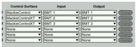

In Ableton Live, set up the top section as shown below in the first attachment.
Then turn remote on on BMT 1, BMT 2 and BMT 3 as shown in the second attachment.
Then everything should look like a Mackie MCU control surface for Ableton Live while your DM2000 is in Mackie HUI mode. All faders, solo,pan, mute, transport, V-POTs etc should work and you will have a lot less mapping to do.
