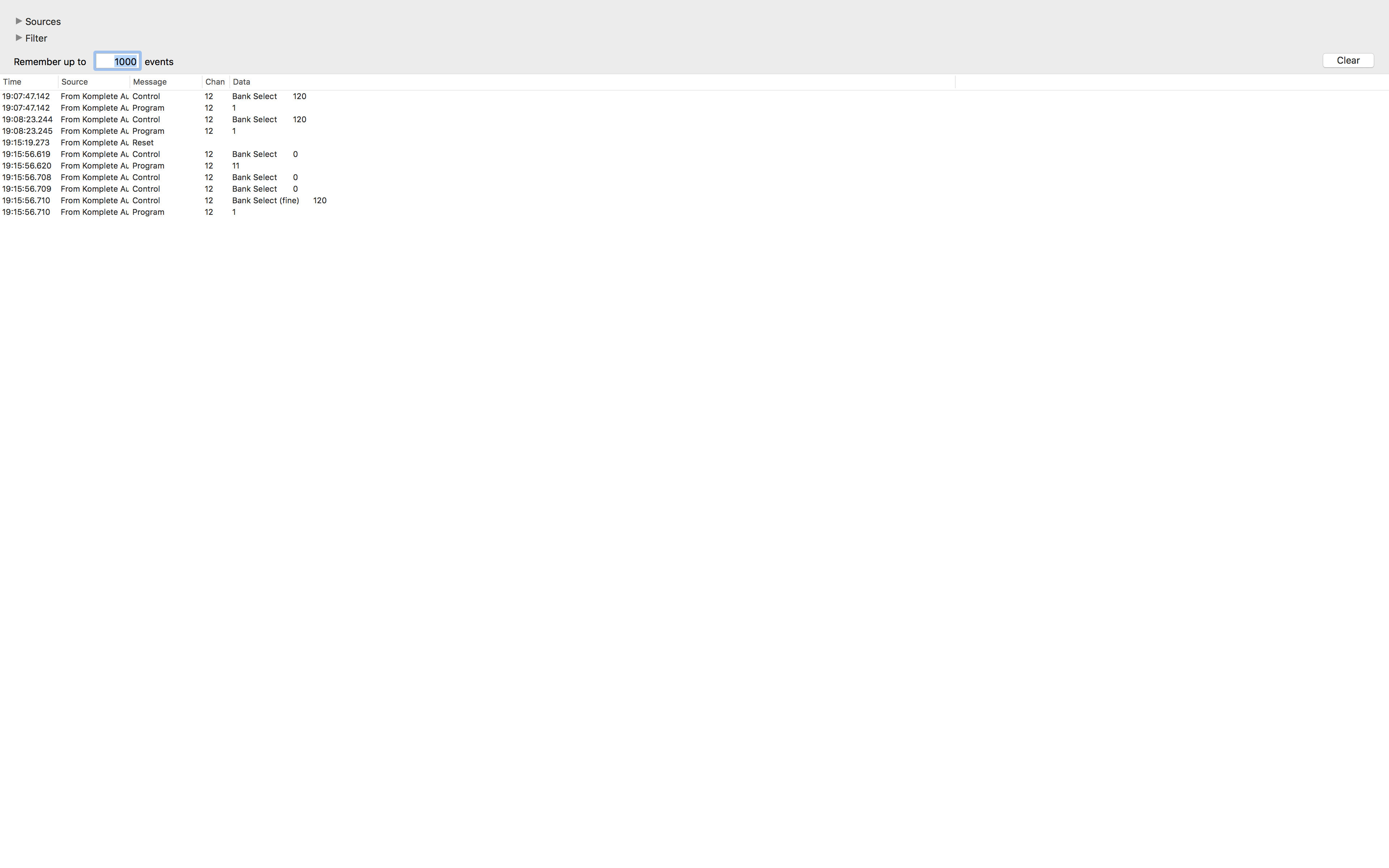

Hello Steve,   Attached is a diagram of the setup.  Like you said everything is being sent to Bome box.  What I want is my external gears (M6000, UAD LIVE RACK, BRICASTI) being able to follow the different snapshots of my desk (ALLEN&HEATH S5000).  For the moment leaving the preset and the translator levels undefined the UAD and the M6000 are following the snapshots.    I've got two problems with the Bricasti.  First one : If I unplug the M6000 and plug the Din5 from the Bomebox straight into the Bricasti it's not working well because the register bank (user bank) of the Bricasti starts in 120. So I made a translator but it still not working. Using midi monitor I monitored what I was sending to the Bricasti. What the Bricasti received was different from what it would like to receive so the preset didn't switched to the one I would like.  I put two Bricasti back to back and I used the learn function of one Bricasti to send the midi message to the other. I was able to change the preset of the Bricasti I wanted to use. I monitored that as well.  I've done a file that I attached.  There is two times the monitoring of what the Bricasti wants to receive (19:07:... and 19:08:...) and after what the creation of the translator transmit to the Bricasti (19:15:56.) The difference comes from the Bank Select (fine) apparently. I talked to someone from Bricasti this afternoon. For him the message is different from the one the gear is able to receive so it stays stuck to the bank select 0.    Second One : With the Setup I have for the moment, the Bome Box should send the midi program change to the TC M6000 and the TC M6000 should send it to the Bricasti.  The problem is what I would like to send to the M6000 should be different from what I would like to send to the Bricasti. M6000 needs Bank 0 and Bricasti absolutely need bank 120.  Do I need to add a second midi router like a Iconnectivity midi router with 2 different Din5 outputs?     Thx

No account of the different midi channel assignement I have to make if I want both of them working together on the same din5, If I unplug the M6000 and plug the Din5 from the Bomebox straight into the Bricasti it's not working well because the register bank (user bank) of the Bricasti starts in 120. So I made a translator but it still not working. Using midi monitor I monitored what I was sending to the Bricasti. What the Bricasti received was different from what it would like to receive so the preset didn't switched to the one I would like.  I put two Bricasti back to back and I used the learn function of one Bricasti to send the midi message to the other. I was able to change the preset of the Bricasti I wanted to use. I monitored that as well.  I've done a file that I attached.  There is two times the monitoring of what the Bricasti wants to receive (19:07:... and 19:08:...) and after what the creation of the translator transmit to the Bricasti (19:15:56.) The difference comes from the Bank Select (fine) apparently. I talked to someone from Bricasti this afternoon. For him the message is different from the one the gear is able to receive so it stays stuck to the bank select 0.
The bricasti is a V2. I talked with someone from Bricasti yesterday and he is pretty sure the problem comes from the fact the translator is not sending a good bank change signal. Maybe due to the fine in brackets in the file attached.

Yes try a Bank select of value 15360 instead of 120 since it looks like they are looking for Bank select MSB (most significant byte).  15360 is 120 shifted to the left by 7 bits.
Alternately you can do this in rules and then send raw MIDI:
pp=120
// the below shifts pp value to the left by 7 bits
pp=pp<<7
Outgoing message Raw MIDI: BB 00 pp CB 01
BB is CC  change on MIDI CH 12
00 is value of zero (these are zeros not o\'s)
CB is Program Change on MIDI CH 12
01 is program change value of 1
Most systems also accept LSB (fine tune) so you might have to add CC 32 with value 0f 0 before the program change.
BB 20 00  (20H is 32 decimal)
By the MIDI standard technically the full raw message should look like this:
BB 00 78 BB 20 00 CB 01
(78 is value of 120 decimal in hex)
For MIDI CH 1 use B0 and C0 instead or BB and CB. The second digit B is MIDI Channel 12 which is 11 decimal. The first B is for CC change and the first C is for Program change.
