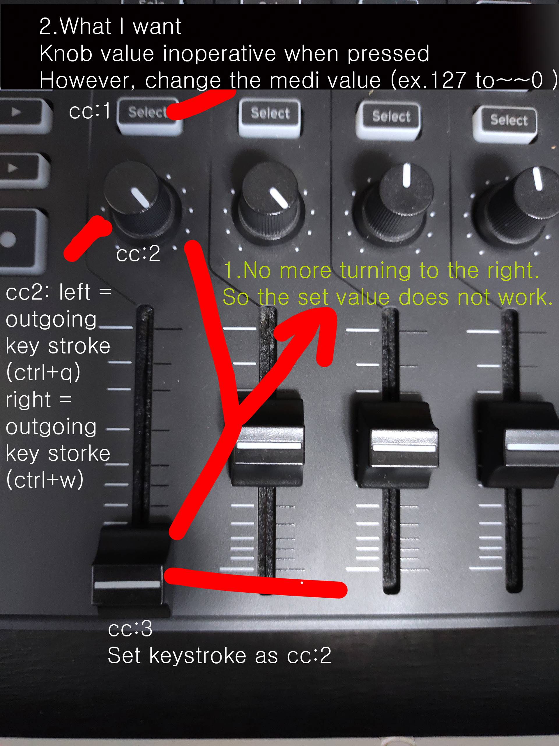

1.I'm want to use a midi controller for a capture one
2.my controller is korg nanokontrol studio - This is the absolute value knob. and There is also the end of the knob.
3.Look at the jpg file. and my bmtp file and youtube(https://youtu.be/Asj748xBJXM)
4.The operation I want is this.
1.(ex) Press the cc:1 button.
2.Outgoing(KEY STROKE) of CC:2 and CC:3 does not work.
3.The MIDI values of CC:2 and CC:3 change. (0,1,2,3,4,5,6~~127 / 127,126,125~~0)
4.Press the CC:1 button again to activate Outgoing of cc:2,cc:3.
Is it possible? Thank you

1.Example Situation
CC:2 Knob Location PP 60
Turn left. PP 58
Keystroke twice operated ( keystroke ex. left key) Trun  right. up to PP 61 keystroke three operated (keystroke ex. right key) 2.Example Situation 2 CC:2 Knob Location PP 127 I want to turn the knob to the right to operate the key stroke(ex.right key) applied to the right. But The knob went all the way. --- I want the knob and slider to work in different keystroke depending on the direction. and I use a midi controller for photo correction. Therefore, it is not allowed to automatically repeat keystrokes.
I want to enter only the value I want. Thank you!

I want to enter a different key stroke depending on the direction of the knob. But the handle has limitations in its movement I want to solve this.

that's not what I want. If the key stroke is repeated, it's hard to get the value I want. If the knob moves once, The keystroke also wants to work once.
2020-03-11 04:52:13
OK, I'll send you a version tomorrow so that if you run out of room you can push a button and recenter the knob. Is that what you want?
zidhs123
2020-03-11 05:04:23
Yes. 1. run out of room – CC:1 Push 2. Center(or To a position where space can be created.) the CC:2 knob or CC:3 slider again. – no keystroke. but midi value change. 3. CC:1 Push 4. CC:2 Knob or CC:3 slider Activate the keystroke according to the direction. (ex.knob turn left-keystorke left key, knob turn right-keystorke right key Thank you!!!

Hi, in this iteration I disabled the original 2 presets that used timers.
This first 2 translators of the preset "CC1 - No timer" , disable and re-enable the knob output.  If you run out of room on the right, you push a button, move the knob to the left, release the button and  now you have more room to move on the right.
If you run out of room on the left, you push a button, move the knob to the rightt, release the button and  now you have more room to move on the left.
For my example I used an incoming note 1 on MIDI CH 1 with any velocity but you will likely need to replace that with what your button sends.
The other preset (CC21) is similar except I did it on my Novation Lauchkey MINI  that does not have programmable buttons or knobs. I just used the incoming messages that they had as convenient.
Pushing the button, sets a global variable ga to 1. Release it sets it back to 0. When you turn the knob, it will only output keystrokes when the global variable variable is set to 0.
I use a different global variable for each knob in this example but you could use the same one for all if you want the single button to disable/enable the output of many knobs.
I hope this helps!

Hi, Steve. Perfect! I set the note key to toggle in the KORG editor. Press 1 and CC:1 will not work. Press again to set CC:1 to work. It's by your favor. Thank you!
