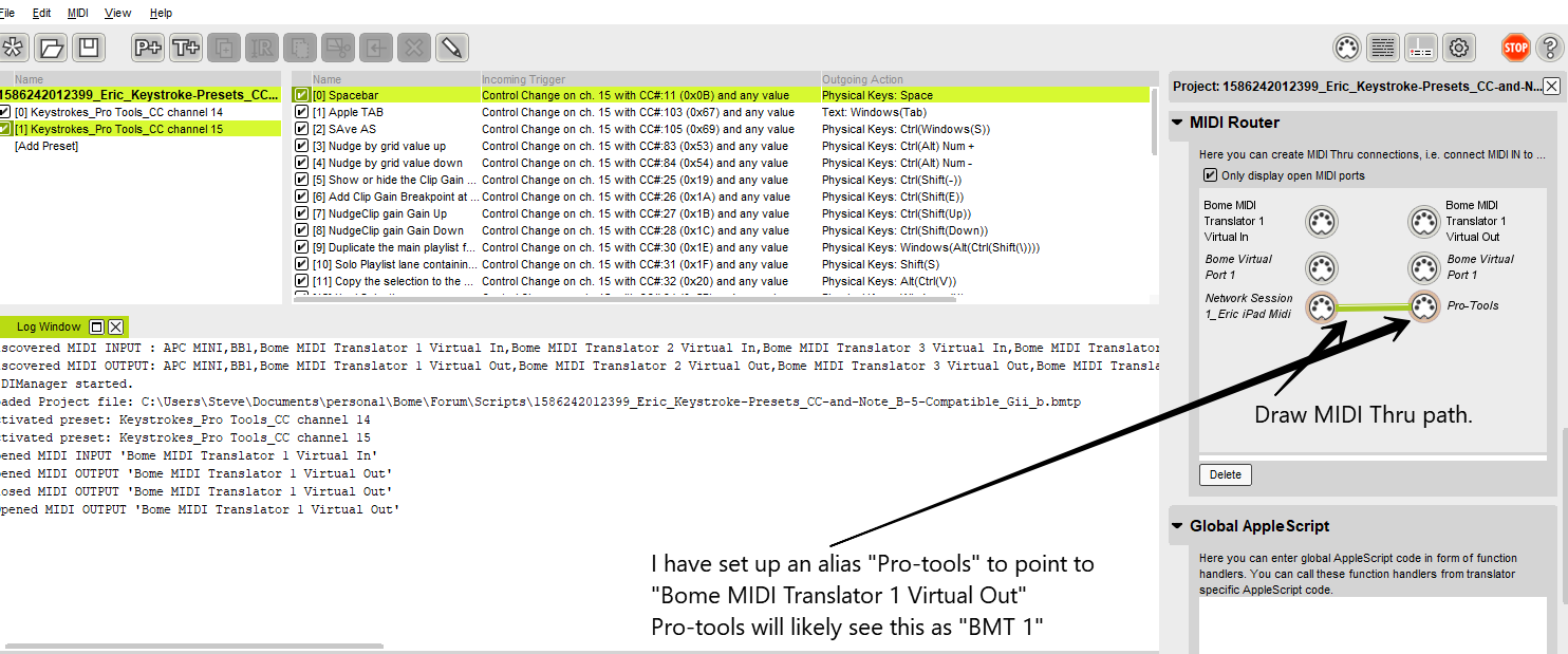

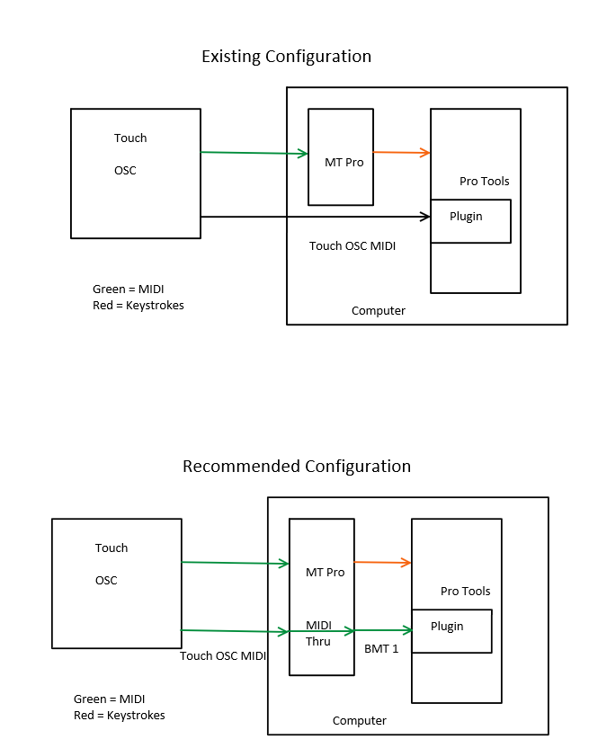

Hi, in looking at your project file, it appears that you are note passing through any MIDI via MT Pro. You must have Pro-tools looking directly at your Touch OSC MIDI port instead. If you want to block these messages, you must set up Pro-tools to look at a Bome Virtual MIDI Port instead of the Touch OSC directly.  You can then set up a MIDI thru path for the Touch OSC to go to a specific plugin and then swallow anything you don't want to pass through.
I've added this path in the attached project file.
See attached diagrams.
