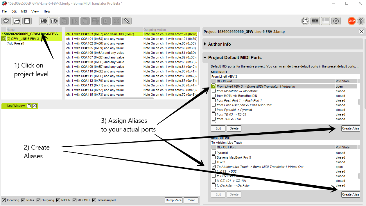

See diagrams below.  In MT Pro you:
1) click on project level so you can see assigned input and output ports
2) Create meaning full alias names
3) Check the boxes for the aliases you want Line 6 FB3 In from your controler and Ableton Live (Bome MIDI Translator Virtual port 1 BMT 1) to send to Live

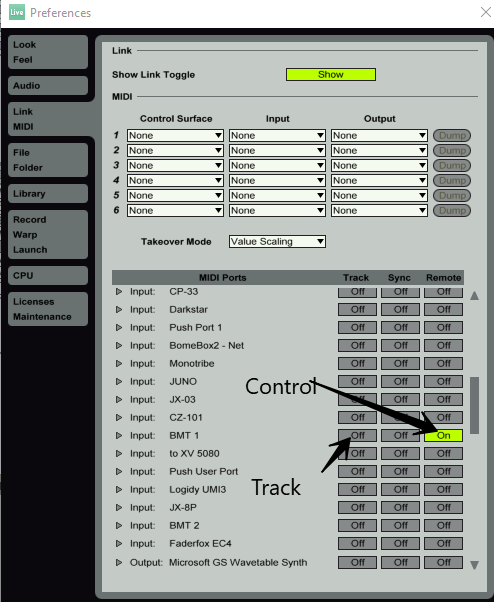

In Abelton Live MIDI Preferences assuming you want this to control functions Click BMT 1 for input to match what you did in step 3 above.
Then use MIDI Learn in Ableton Live to assign what you want to do.
Also I noticed that on your first transator you were sending value pp as output. Since pp is a local variable, by definition the value is unknown unless you assign it. I assume you really want output of 127 so I set it in the attached.
GFW-Line-6-FBV-3-sjc.bmtp

Sorry didnt get a chance to fully test it out until today. There were some settings in Ableton Prefernces I had to experiement with also in regards to the FBV 3. The Bome settings in Ableton are the same as the IAC settings so I will remember that. I think I actually like the the stock devices instead of the Aliases. It's a nice touch, but I guess I am just use to Abelton. My instincts were right in my settings in Bome, but the setttings in Ableton didmt jive.
I ended up deleting the pedal pass through off CC it just complicated things and was very choppy. Extra step in processing that wasn't required I suppose. Thanks again for your help!
