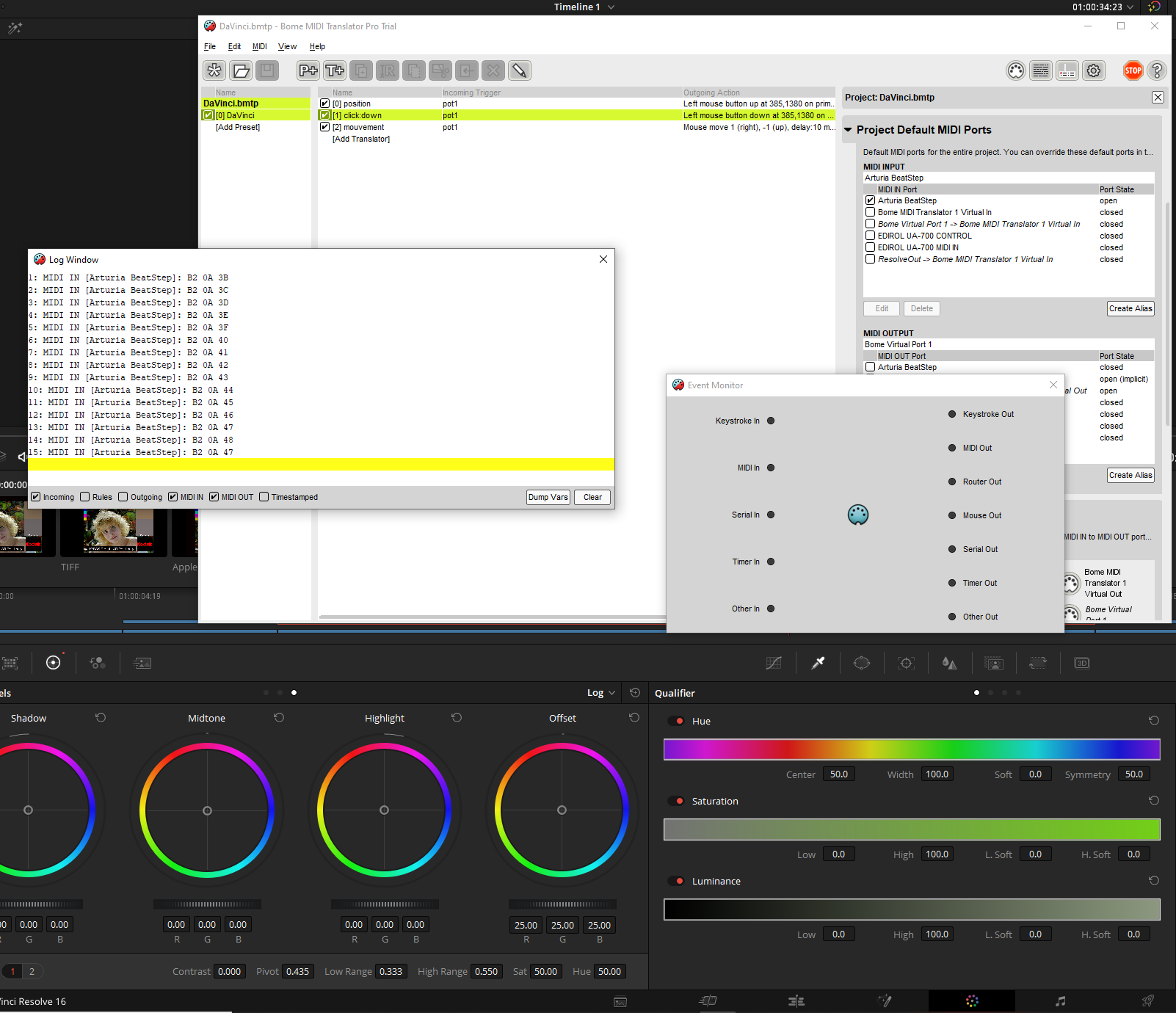

Hi Steve, I move the knob, the number moves but only by two points and infinitely rotating the knob. Attached is my project I hope it can make me understand where I'm wrong. thanks

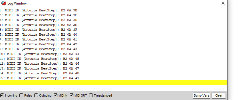

Can you show me a log of what your knob sends when turning it each way?

2020-05-04 16:50:54
Hi Steve, that's the Log

2020-05-04 17:43:21
OK, are you trying to control the numeric values in the RGB Boxes or are you trying to move then wheel above them? Our strategy will depending on what you are trying to do. If the wheel, it would be best to set the encoder to put out relative values. Controlling the numbers in the boxes will be much more difficult but I suspect it can be done. Will just have to take a while to figure it out.
