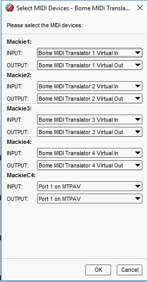

I did like you say, but i do not know how to setup your project in MTP. What should i put in:
Mackie1 INPUT/OUTPUT
Mackie2 INPUT/OUTPUT
Mackie3 INPUT/OUTPUT
Mackie4 INPUT/OUTPUT
MackieC4 INPUT/OUTPUT
What is the right assignment here? Should i create 5 virtual midi-cables, with these names?
What do i assign as midi input/output for the four Mackie Control units that i have in Cubase?
2020-05-20 19:43:24
Aliases
Mackie1 - BMT 1 - First Cubase Mackie Controller (last on the list in Cubase)
Mackie2 - BMT 2 - Second
Mackie 3 - BMT 3 - Third
Mackie 4 - BMT 4 - First (top of the list in Cubase
Mackie C4 - To and from your Mackie C4 controller.

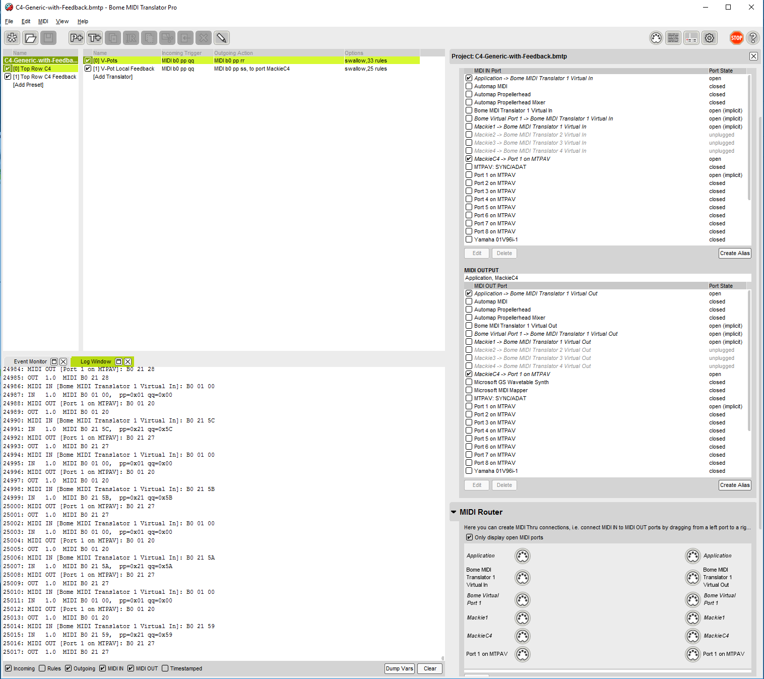

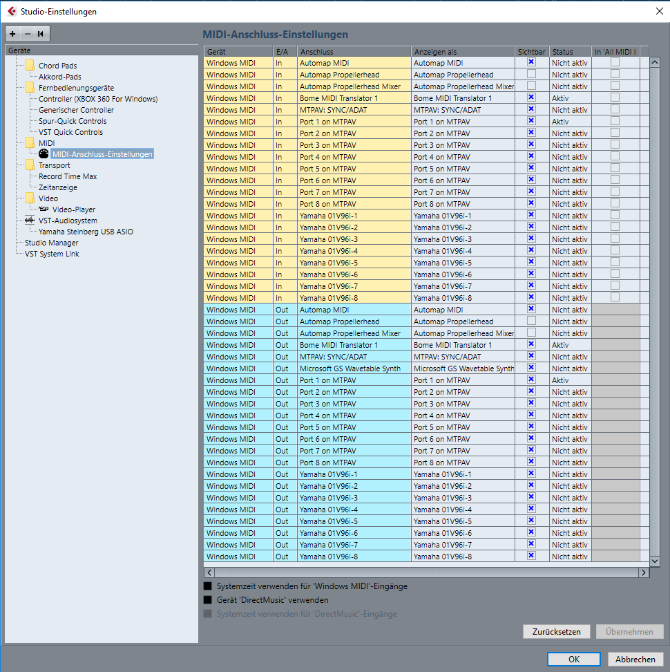

2020-05-20 21:31:05
pan settings are working correct now. everything else, is like before (obviously :) ).
i attached pictures of the setup. so you maybe have a clue, what else could be wrong.
2020-05-20 21:46:47
Can you post a screenshot of how your aliases are set up in MT Pro? Also disable any ports that are trying to connect directly to your C4 from Cubase.

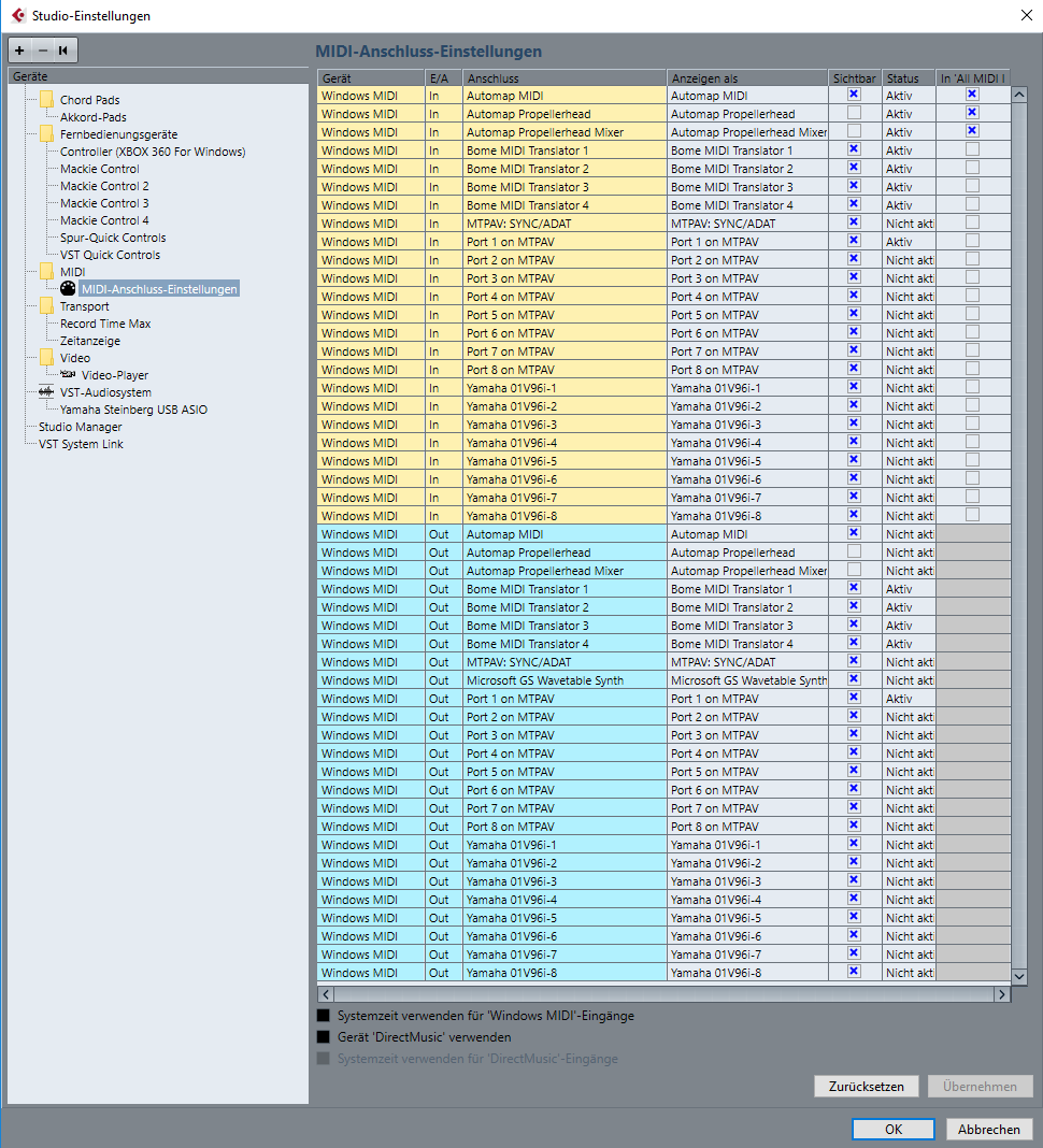

2020-05-20 22:01:25
I am sorry, but what do you mean by aliases in MT Pro?
I think there is really nothing in Cubase that uses the ports for the C4. I checked it right now.
In the picture it is Port 1 on MTPAV. That is where the C4 is connected.
I am sorry, that there are so much midi-ports in the Cubase picture :/ .
Here again the midi-setup in Cubase, comparing to before, this time Port 1 is \"inactive\" for both midi in and out, so nothing uses it.
2020-05-20 22:15:20
In MT Pro click on the menu item MIDI then Edit Project Port Aliases. You will see a screen shot of how your aliases are assigned.

Here it goes:
2020-05-20 22:29:15
That looks correct. I just tried this with the following project file although my devices sends 41(65) for positive and 3F (63) for negative. Just disable my presets and enable yours and it should work although you might have reverse encoders again.
After disabling the conflicting ports on Cubase I had to shut down Cubase, the MT Pro, then open MT Pro first then Cubase.  I tested with just virtual devices though.
What gets returned to the controller is the same CC it sends however the values are the same as the Mackie MCU doc calls out of encoder rings.
So for the first 8 you should see B0 00 qq  through B0 07 qq - qq will be a value from 0-12
For the second at it would be B0 08 qq through B0 0f qq
and so forth.

2020-05-24 22:31:46
I could do it for encoder feedback if I had a C4. The attached should work correctly if you set up your C4 correcty and the feedback that was required is as you described.
Without adequate documentation or a controller, it would be difficult to set this up with any controller let alone a C4.
If you set up Cubase for 4 Mackie controllers with the port numbers as I previously described  and set you C4 knobs to 0-31 then it should work. If it doesn't then the specification or requirements you described are incorrect and without proper documentation or a C4, there is nothing much more I can do.

2020-05-25 17:04:25
I'm hoping this will help.  You can use this as an example if you want to use your C4 with Cubase as a generic controller instead of Mackie MCU.
For sending to Cubase, I'm converting relative CCs from the controller to absolute to send to Cubase.  I use MIDI Learn in Cubase and as far as Cubase is concerned they come in as absolute values.  I only programmed CC0-3. I store the calculated absolute value of the CC in global variables g0-g3 on messages going out to Cubase (Alias Application). (Translator 0.0)
For LED ring feedback, I again capture the feedback absolute value in g0-g3 so that the CC values stay in sync.
For conversion,  I take the absolute value and convert it to what the M4 should expect.
(Translator 1.0)
I leave the center detent off and the LED ring type to wrap. I left a line that can be uncommented if you want to change the center detent to on which is bit 6)
I also set the LED ring type here (bits 4-5)
I then scale the incoming value of 0-127 to a value of 0-B which is what I believe the C4 needs. ( I have no way to verify this as I do not own a C4).
I then OR the incoming value from Cubase with the LED Ring type and send it to the C4.
It also seems that Cubase does not send feedback when turning the knob on the controller.
For this I use the same logic for local LED feedback (Translator 0.1) as I did for Cubase feedback (Translator 1.0). Note if you need to change the detent and ring type you will need to change them to match in translator 0.1 and 1.0
I made no attempt of updated text display since in generic Mode you will not see text coming from Cubase.  I guess if you know the proper SysEx format, you could convert standard CC messages to various SysEx messages to have some control of your text displays.

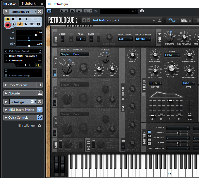

Here is what is happening:
Absolute values work, but in reversed. So turning left is inc. and turning right is dec. other than that, steps are +-1, so this works. Thumbs up.
The Feedback works, but only the one i do with my mouse. So turning i.e. Cutoff with the mouse, reflects correctly on LED rings. But turning the encoder, has no effect on the rings. Could be something i did wrong, either in MTP or Cubase or both (nah!).
Pictures of setup are attached. Nice work :)

No, I think you are doing things OK and both issues are related
I added the following rule to reverse (in bold)  the direction sent to Cubase.
tt=qq&15
// Reverse direction since last iteration
tt=tt*-1
if qq<64 then tt=tt*-1
Give it a shot and let me know what happens.
C4-Generic-with-Feedback-a.bmtp

Hi, I did a little testing this morning.
It seems that Cubase likes to put out text of length 55, 3, 2 and 1 (not including Header and trailing F7)
So I created 4 additional translators (for Mackie 1 only) with these lenghts and am posting it here.
I also added a generic Mackie handshake answer which I use and works. I actually have a APC40 MKII Mackie emulation.
I modified the incoming text Sysex from Cubase for the new device ID of 14H instead of 10H.
Again, No way to completely test without an actual C4.
I hope it works!
I'm also attaching a text log file of the example capture I used. I was merely turning V-Pots to get updated display.
This whole project  should work only in Mackie Mode only (Not generic mode).
