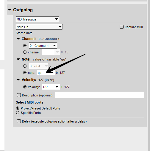

2020-06-03 14:28:20
Hi Oliver,
For outgoing action, just put qq in the box for the out outgoing note number on the output side over on the right. See attachment.
As far as loops, the way to do it with MT Pro is repeating timers where the timer increments or decrements a global variable each time it is called.
I also took the liberty of creating a translator that will convert from a Chromatic to Lydian Scale using math.
The way it works is we define the note conversion in a single octave and then we expand to  use with any octave
I set it up so you can use any starting note. It the attached case I used note 60.
Here are the rules. The input note is variable pp and the output note is variable qq.
