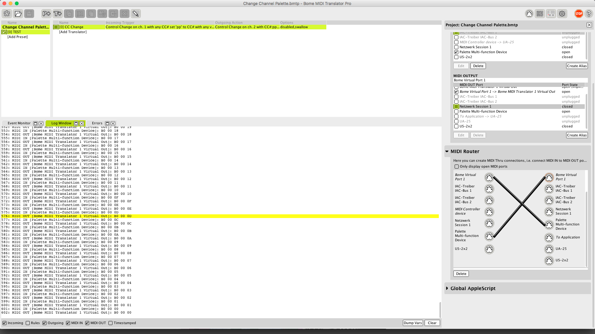

thanks for your quick answer - just in the moment i saw, if i activate "incoming" and  "outgoing" in my log window - there is no data coming to the window - only MIDI IN and MIDI Out show me some data - is it a problem of my preference settings? - in the attachement you can find my file - greetings wolle
		2020-06-03 15:22:44
	Yes, in general for incoming MIDI messages if you see MINI IN but no Incoming, then you have your incoming trigger parameters set incorrectly. I could tell by looking at your log window.

	is this screenshot sufficient?

	The only thing I see wrong is that the translator is unchecked which means it is disabled. Therefore no translators and everything goes through the default thru path untouched.
		2020-06-03 16:19:52
	OK, I guess somewhere along the  line you re-enabled the translator.
