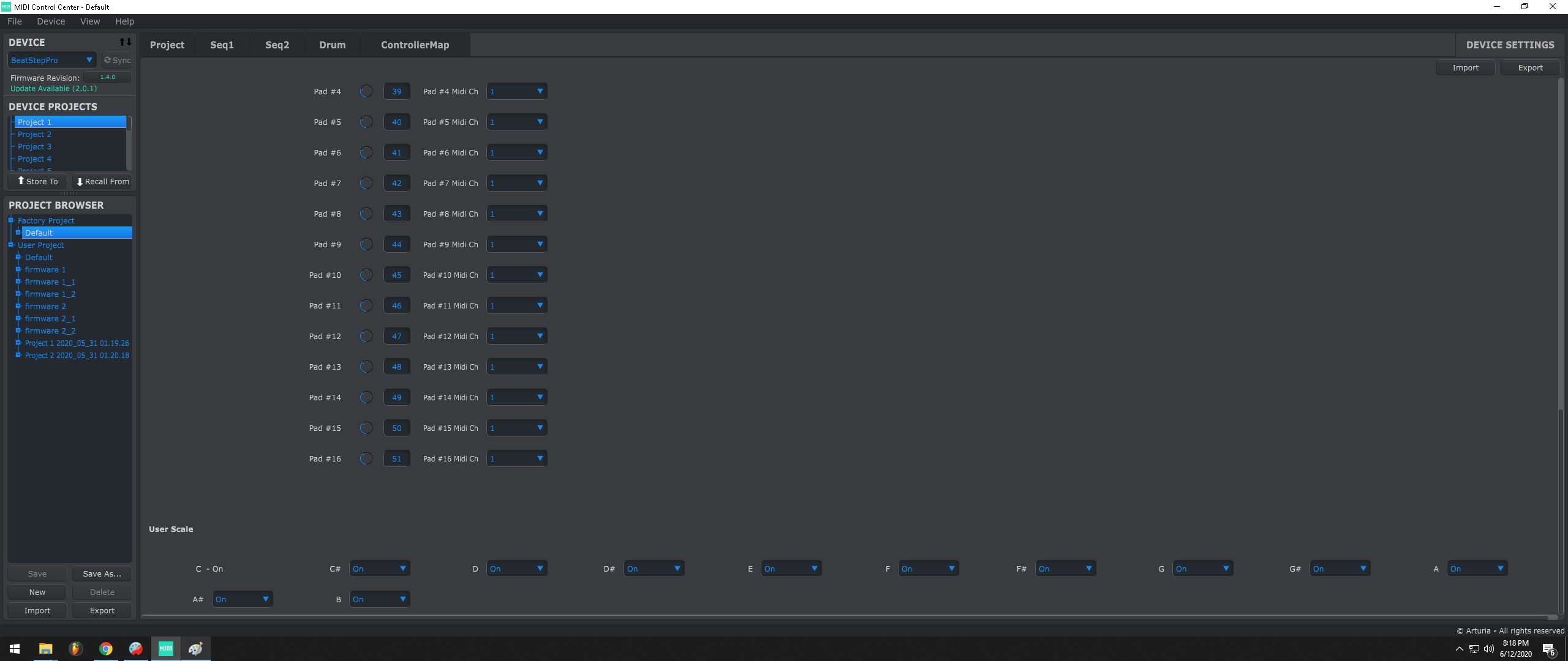

hi, in FL Studio: controller sync (clock out) : Beatstep Pro.the beatstep syncs up fine. I have enabled beatstep pro as midi input to use the transport buttons (play/pause) under the controller i set it to M-Audio Oxygen 25 keyboard . the CC notes for that are: Play: cc 117 Stop: cc 116 Record: cc 118 ..... I changed the notes in Beatstep Pro midi control editor to those notes accordingly. FL Studio recognizes the notes just fine. but it freezes/ and the beatstep pro lights go crazy and freezes as well (midi feedback loop) . So right now i cannot use/ and have changed the notes on the beatstep pro back to default so i dont accidentally trigger them and cause a midi loop feedback while working on a project. Is there a workaround?or how to prevent a midiloop feedback ? this controller is a bit expensive lol. I have contacted Arturia and they know about the issue but no fix!! lol

beatstep pro setting... no midi thru option.
