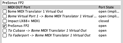

Yes, I've asked someone else to look at the crash dump. I recognize the project file, however not sure whether you are duplicating messages to your FaderPort since the Cubase CC to Fader preset has both "To Faderport" and "PreSonus FP2" defined as output ports. If "To FaderPort" is an alias for "Presonus FP2" then you should uncheck "Presonus FP2" as one of your output ports in preset "Cubase CC to Fader" preset.

I think the duplication is there because its setup so that messages get sent from the Faderport to Cubase and because its a motorised fader, messages also get sent back to the FAderport.

I think I misunderstood the earlier post about about the duplicate ports.
I took the virtual port to faderport off and it still works. I keep an eye on it if that fixes anything.
