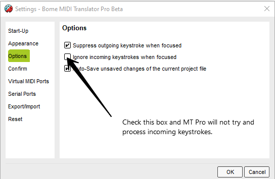

SJC> If you are triggering events with these messages, you probably do not have "Ignore incoming keystrokes when focused".  Please go to  View-Settings and the Options ann check that box.  Then   MT Pro will accept the keystroke instead of processing it.

Suppressing keystrokes doesn't help in this case, because the MTP window has to be focused for that to help.
I'm testing it right now.  The MTP window is open, with those settings enabled running behind google chrome,  and typing this out isn't working, it's firing off translators.  I had requested a 'suspend MTP' feature.  It's just a minor request though.  I do need these translators to be working when using FL Studio.  So what I currently do is just close MTP whenever I use the internet.  Then open it again when swapping back to FL Studio.  Which involves the whole MIDI Buddy output port/suspend hotkeys setup process.

Hi, when developing the application, supress keystrokes so that you can enter them into the text box instead of processing them.  When development is complete, then you can uncheck the box so that normal processing happens.

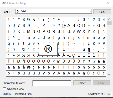

You can use the Windows Character Mapper to select certain keys and then use the Alt Sequence in the lower right corner to enter them into MT Pro (if keystrokes are suppressed). As you can see in the illustration, the keystroke for the registered trademark is Alt(0174).

The character map is a great solution, thank you.  Tried it in wordpad and it actually makes a symbol.  Nice, I will try and struggle in some macro changes with that.

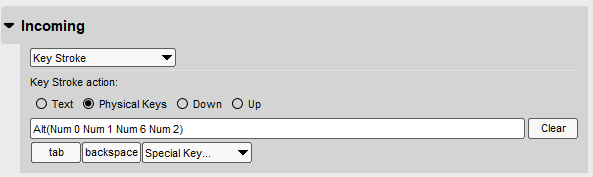

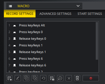

The character map keys aren't working, I've tried a couple.  Alt(0161) and Alt(0162).  Instead of MTP doing the translator, in both cases FL Studio asks me if I want to save the project  (Ctrl+S).  ?
My fearless picture snipper won't capture that full scrolling window for some reason.  The end says 'release alt'.
So I'm outgoing Alt(0162) from iCue and incoming Alt(0162) into MTP.  The 'text' or 'physical keys' options have the same result.
SJC> Right FL Studio is probably trying to interpret these keys (because they don't get suppressed).

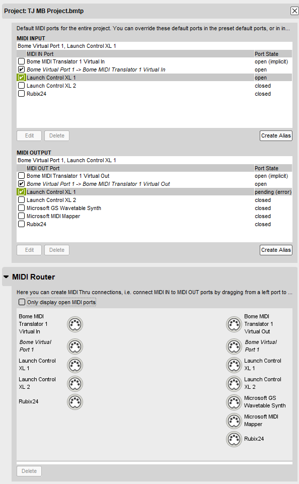

Hi, sorry but I can't seem to get this virtual port thing working with the Novation Launch Control XL.  I tried basically every routing I can think of.
No matter what I do, if Bome is running, FLS says 'One device can't be opened.  Maybe it's used by another program or have enough memory'.  If I close Bome, it runs fine in FLS.
The knobs on the unit I need to link with FLS parameters, but the buttons I need running mouse translators through Bome MTP.
2020-07-18 23:17:46
Try the attached.
The input is from Launch Control XL at the project level.
Preset 0 (Knobs) is set up to send only to FL Studio 1 (which on my system is aliased to BMT 1)
The translator under that preset will take any CC and pass it through untouched
Preset 1 (Buttons) has two translators. One for note-on and one for note-off.  At the preset level everything is routed to FL Studio 2 (which on my system is aliased to BMT 2)
Again, the messages are just passed through.
In FL Studio I disabled the input from Launch Control XL (remember only one application can access a given MIDI port at a time on Windows.  Instead I have my inputs defined as BMT 1 (for CC)  and BMT 2 for (for notes). I have them both set up as generic hardware ports so you will need to do the CC and Note mapping yourself. If you want different note or CC mapping, you will need to modify or add translators to MT Pro for what you want.
Right now, I'm not looking for any revers mapping (FL Studio back to your Launch Control XL).
It is important that you don't try to open the original LaunchControl XL ports in FL Studio and use the Virtual ports instead.
Review the below tutorial for how you can use presets and translators to route given MIDI message.
