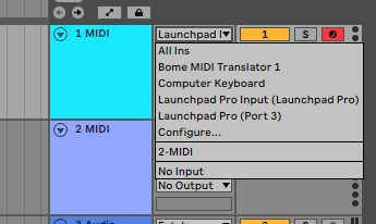

Hi, I want to make my Launchpad Pro as game controller like the above YT video.

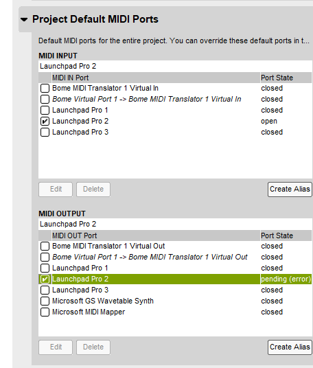

When I open Bomes MIDI translator only, keystroke functions works fine.
but if I open Ableton Live for light effect, MIDI Translator stops working.
I can see above YT video it says, "same Input both Ableton and MIDI Translator"
I select Launchpad Pro 2 as the input in MIDI Translator but, I can't find same inputs on Ableton Live.
How can I solve this problem?

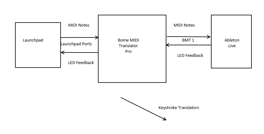

My guess is he did this on a Mac which allows assignment of same MIDI port to multiple applications. On Windows platform, only 1 application can access a given port at a time, so you will need to  route your Launchpad to a virtual MIDI port (IE BMT 1) in Ableton live so that it can read the MIDI signal from Ableton Live.
See attached diagram.

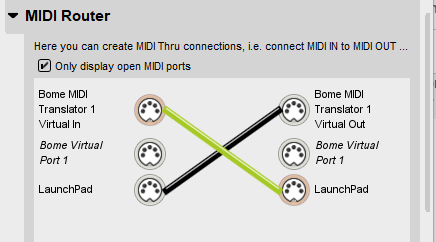

ok so how do I route my Launchpad into Virtual Midi port?
2020-07-19 18:25:21
SJC> In MT Pro, once you open your ports , draw a line between the inputs and outputs in the MIDI router
seongkyu2012
2020-07-19 18:41:09
I don’t know I did right, sorry I am bad english. I draw the lines like above your picture. and in the Ableton, MIDI From : Launchpad Pro Input Ch.6, MIDI To : Bome MIDI Translator 1 Ch.1, MT Pro Log get the Midi signals but keystroke doesn’t work. And if I choose MIDI From : Bome MIDI Translator 1, it doesn’t catch any signals.
