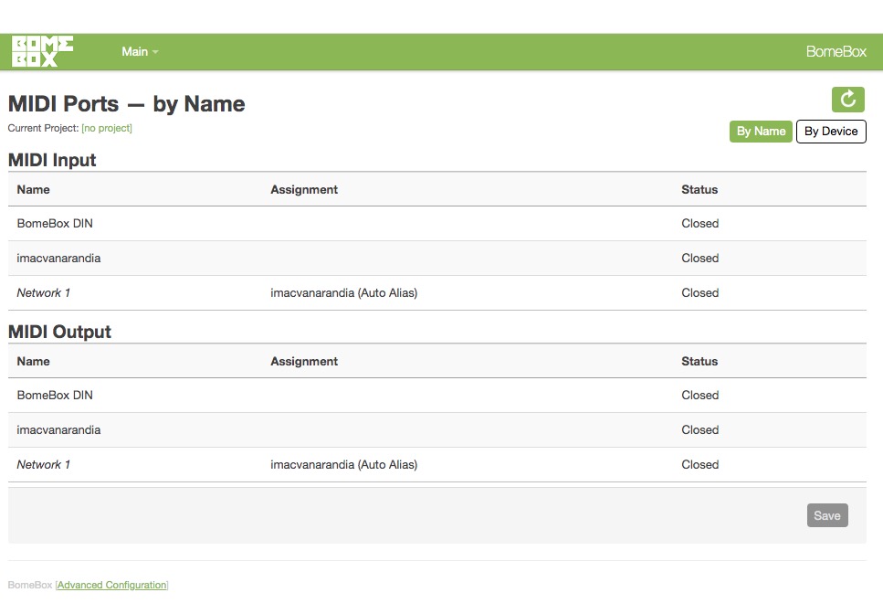

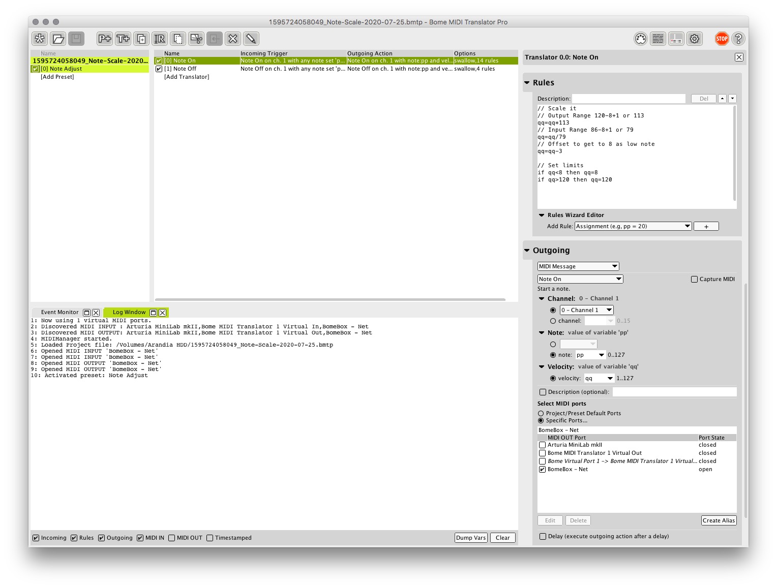

Hi Steve, i did what you told me to do only i still don't hear any sound coming thru. So i'am sure that i'am doing something very wrong so therefor i made screenshots for all my settings, on your advise. Maybe you are seeing whats wrong.
Thank again.

2020-07-30 10:39:08
Hello There Steve, trying again (with shame because how difficult can it be, hehe...)
Carlos Alberto van den Berg
2020-07-30 10:40:55
Yes Steve, it worked!! Send you some more, just to make sure! And again super thanks for your patience, :-)
2020-07-30 19:06:45

In your screenshots, it appears you have the input and output set as BomeBox Network, but your BomeBox doesn't seem to have any attached devices or a project file running.
