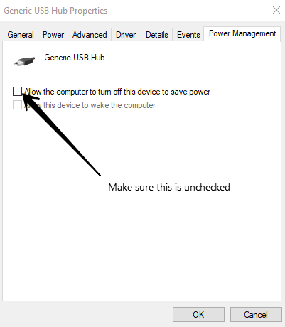

This is usually a function of the operating system. On Windows 10 device manager, go to the USB hub that your devices are attached and then to the Power Management tab.  Uncheck the box that says "Allow the computer to turn off this device to save power".  This should solve it albeit as a side effect, it still may cause more drain on you battery when going into sleep mode.

Turned off the "Allow computer..." on every USB device I could find in the list. The problem is still there.
