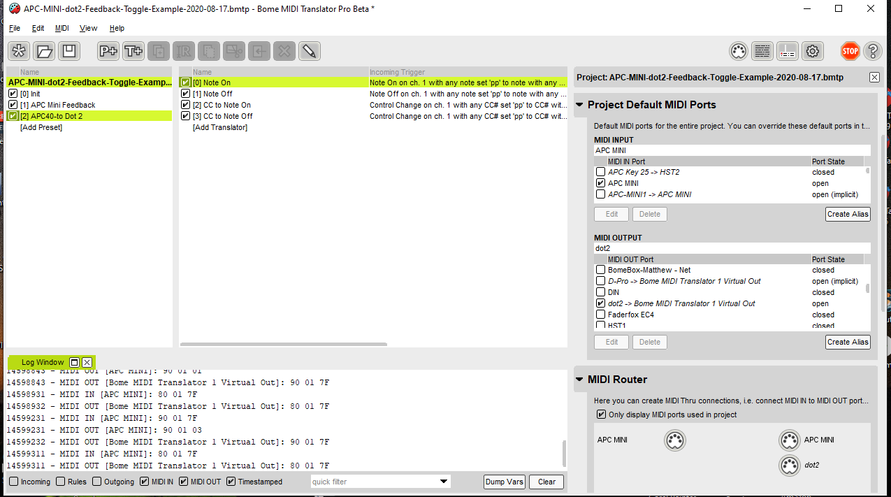

2020-08-17 21:07:08
Hi, you need to set up your aliases APC MINI to point to your attached APC MINI (both input and output) if it is attached by a different port name and the alias dot2 to point to Bome MIDI Translator 1 Virtual Out
In dot2, you need to use the MIDI port named "BMT 1."
Only the two bottom left buttons of the 64 grid note matrix are currently programmed for LED feedback, however all notes will still go to dot2.
If the lights are lighting up green and not going off, then you probably have a MIDI thru path set to and from your APC MINI so you need to remove that.
The rules in translators 1.1 and 1.2 control the LED colors.
See attached screenshots.
