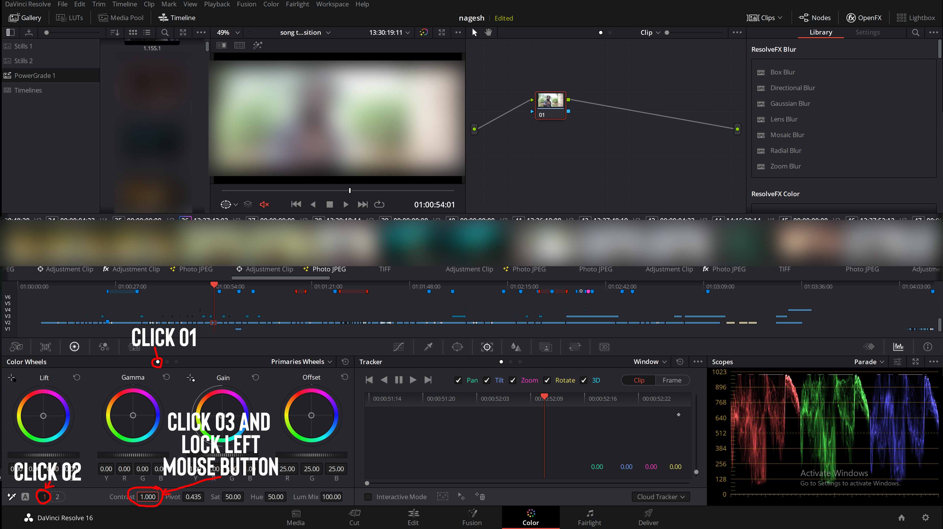

Three clicks are working correctly and I can make it press down left mouse button. After that it will keep on looping.
I want it to be locked and it should make mouse movement in x or y axis so that it should change values as shown in the screenshot.

2020-11-14 14:57:41
Just change the screen coordinates on each the translators. On lock left button, if you want it locked down, just disable the last step (click up) and have the watchdog timer reset the count earlier.
Make sure your mouse coordinates are always the same screen location every time.  MT Pro does not have a way to query screen coordinates.

This was not clear for me. 3 mouse click translators are working fine. After that I am able to make the mouse left click and lock the screen position as per 3rd translator. But after this, when I move the knob, it is looping. Instead I want to move the mouse pointer in X or y axis.
2020-11-14 15:12:54
OK, in this case, after the sequence completes, you need to exit this sequence and replace with a different sequence. It is probably best to put this sequence under one preset, then disable this preset when done, and enable a new preset with the new sequence or action you want for that knob.
