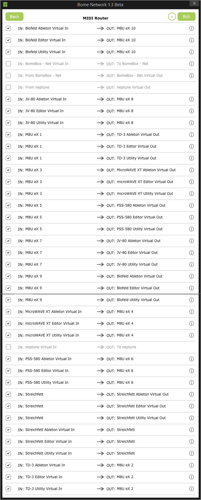

Dear Bome team and forum,
first of all, I am loving the Beta 1.3 of Bome Network Pro and the unlimited Virtual Midi Port extension! I am finally able have a flexible routing on both my local machine and even with devices on a remote machine. Awesome!
However, in several cases I was hoping for the possibility to rename existing Virtual Midi Ports and a also possibility to edit existing Midi Routes. In both cases, I can only delete and newly create them. Is this something that could be added in the next beta? Or is it already possible and I have just missed it?
In some occasions I sensed some instabilities. It is still a beta, of course. But is there a way to debug, are there logfiles I can analyze myself?
Last but not least, I have attached screenshots of my current Bome Network setup. It took some iterations but now it is very convenient. I do not have to think about the actual hardware port an instrument is connected to on my interface. I simply use dedicated virtual ports for each instrument.

  2. This is somewhat convoluted: When I create a connection between my local machine (neptune) and a port on the remote machine (eris), new virtual ports are automatically added on the remote machine: "From neptune: [port name]" and "neptune: [port name]".
    The remote machine again exposes these newly created ports to other machines.
    Back on the local machine, I can now also create a connection to "neptune: [port name]". This makes no sense and it's close to misuse, I know, but it is possible. (see screenshot)
    On the local machine, the BomeNet.exe process instantly dies and I get a CreashDump in %APPDATA%\Bome.
    Remark: creating such a connection to a "From neptune: [port name]" port is not possible, the GUI switch won't toggle. But with "neptune: [port name]" it is possible.
  3. More an oddity, not an instability: When I create new routing entries, I sometimes select one port in the "Add Route" dialog but a different port is ending up in the "Midi Router" list. Unfortunately, this happens sporadically, and I don't have a video of it.
