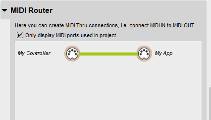

There are two possibilities for your controller.
  1. It is sending keys on a different MIDI port than pads
  2. It is sending keys on different MIDI channel but same port as pads
In either case, you can simply draw a MIDI thru path between the incoming port out outgoing destination in the MIDI router.  If they are on the same port, you will may need to change the velocity translator to only target the MIDI channel that the pads are targeting.
Any activity that does not execute on the translator will pass through any default MIDI thru paths.

I think I'm gonna continue to tinker with it for a lil bit because I still haven't quite gotten the desired results. With the MIDI Thru connexion, you get everything back working, but everything as in it reverts back to the low velocity output.

A little hint on swallow and through paths.
Swallow only works is:
  1. The translator executes the outgoing action or
  2. The outgoing action is none
Otherwise the message will go continue to the through path.
If you have a rule like.
Exit rules, skip outgoing action.
It will NOT swallow unless there is another translator somewhere that meet the above criteria.
