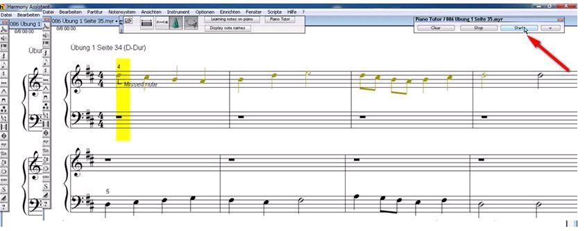

Hi all,
I've now bought me last year, the Yamaha P121 SH.
Super piano.
Question: Since I reluctantly take your hands off the keyboard (especially if the children practice) I wanted to show the start button with the right piano pedal.
Could it work with it?
When I press the right Pedal I get this code
Status: B0,Key: 43, Velocity: 7F
When I left the right Pedal, I get this code
Status: B0,Key: 43, Velocity: 00
How can I enable the START button(From Piano Tutor in Scripte/Training) with the right pedal
My Idee:
I put the mouse over the Start button.
I press the left piano pedal
problem
I needed the command to "click left mouse button"
Then I could turn this button on always on the left pedal
I would be very grateful if you could help me wide.

Hi Frank
What you want to do is totally doable. You need to use Mouse Movement commands as your outgoing action. To be clear, though, since I don't want to assume, when you press the Right pedal your signal is:
B0 42 7F
and when you press the LEFT pedal your signal is
B0 43 00
I just want to be 100% clear. You want to trigger Start when you press the LEFT pedal, not the RIGHT one, correct? Do you also want to select the Stop button, or only the start button?

2014-04-02 12:12:10
many thanks for the help.
Sorry for my bad Englisch. I mean only the LEFT Piano Pedal
The left pedal (soft pedal) is pressed.
The left pedal will then make the left mouse click
The mouse is above the OK button.
The left Pedal thus beätätigt the OK button.
What command would the left mouse click (Outgoing F8)
"Key Stork Emulation" and "Key press of Sequnez"
System: Windows 7 32 Bit
alternative
Pressing the left pedal pressed STOP button B0 42 7F
Releasing the left pedal pressed START button B0 43 00
Thank you very much
Frank

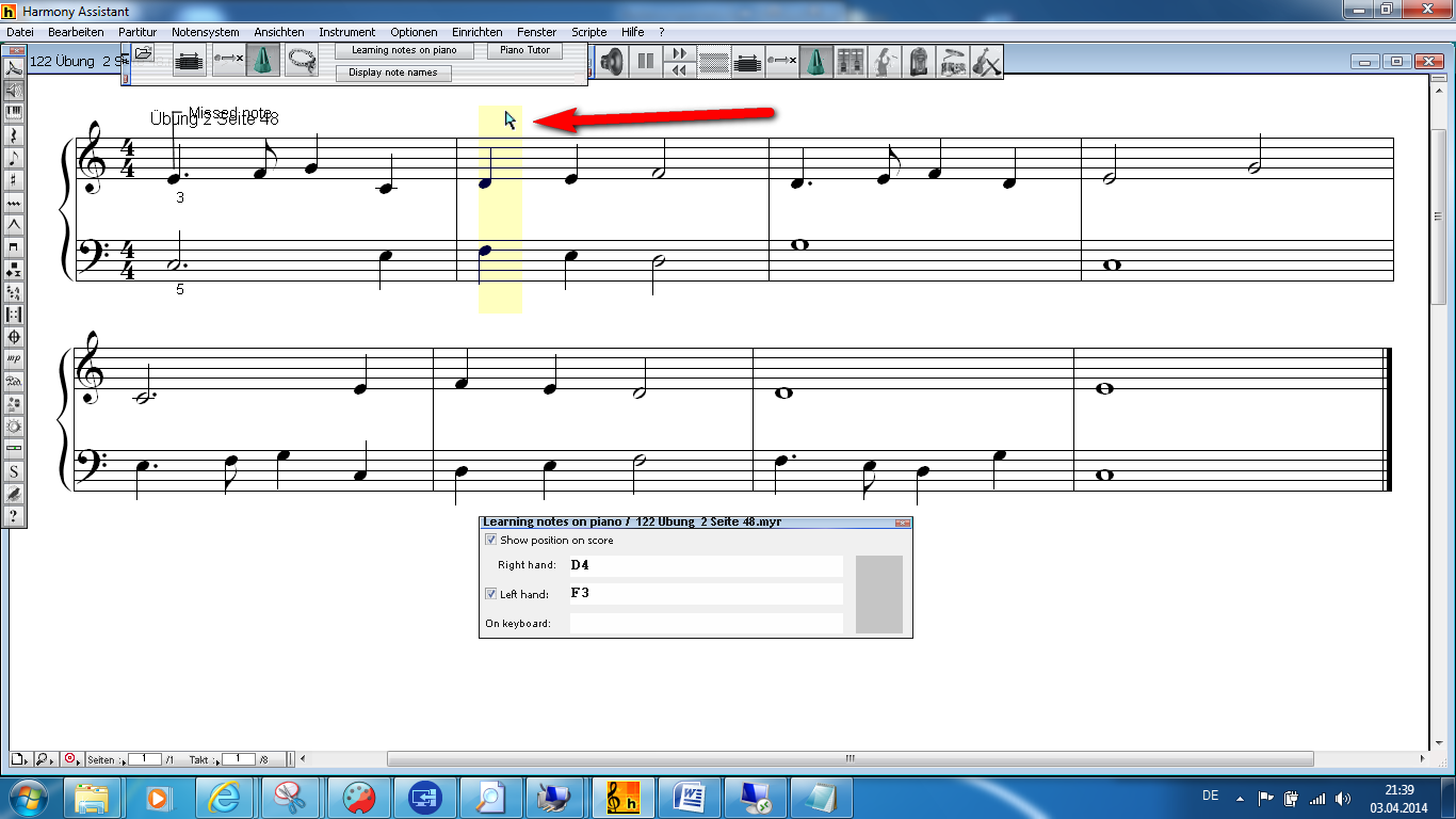

Hello,
I have a question.
In Harmony Assistant, there is the script "Learning Notes on Piano"
I click on a note in a bar.
From this note, my pianoplay is then monitored.
If I want to start the exercise again, I have to click again on the location from which I want to start.
problem:
I try clicking on bar 6 Or times on bar 16.
So do not ever in the same place (like the OK button)
question:
Can "Bome's Midi Translator Pro" Remember the current point where the mouse is.
So I then only can make the left click "with the left pedal?
If so, how?
Thank you very much

2014-04-03 22:09:45
Hi again gutschein
Unfortunately, as of now, MT can't receive a current mouse position, though it is a feature that will hopefully be implemented.

2014-04-04 11:12:31
but it works.
I gave the digit 0 for X and Y.
Thank you very much
