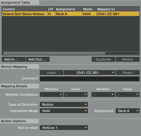

I finally got round to playing with this, and I think I know what it is. You need to send a Note OFF as well. This is why it was working the first time and then again after you have pressed another button...
Here is the translators you will need to use, for the example I have used the very top left button on the APC and translated it to CC Channel 1 Note C# (01).
Code: Select all
Translator 0: Note ON to CC
Options: stop=false
Incoming: MIDI 90 35 7F
Outgoing: MIDI B0 01 7F
Translator 1: Note OFF to CC
Options: stop=false
Incoming: MIDI 80 35 7F
Outgoing: MIDI B0 01 00
The Note ON sends the CC with full velocity and the Note OFF sends 0.
Here is how I have it mapped into Traktor aswell, working great for me...
Hope this works...
